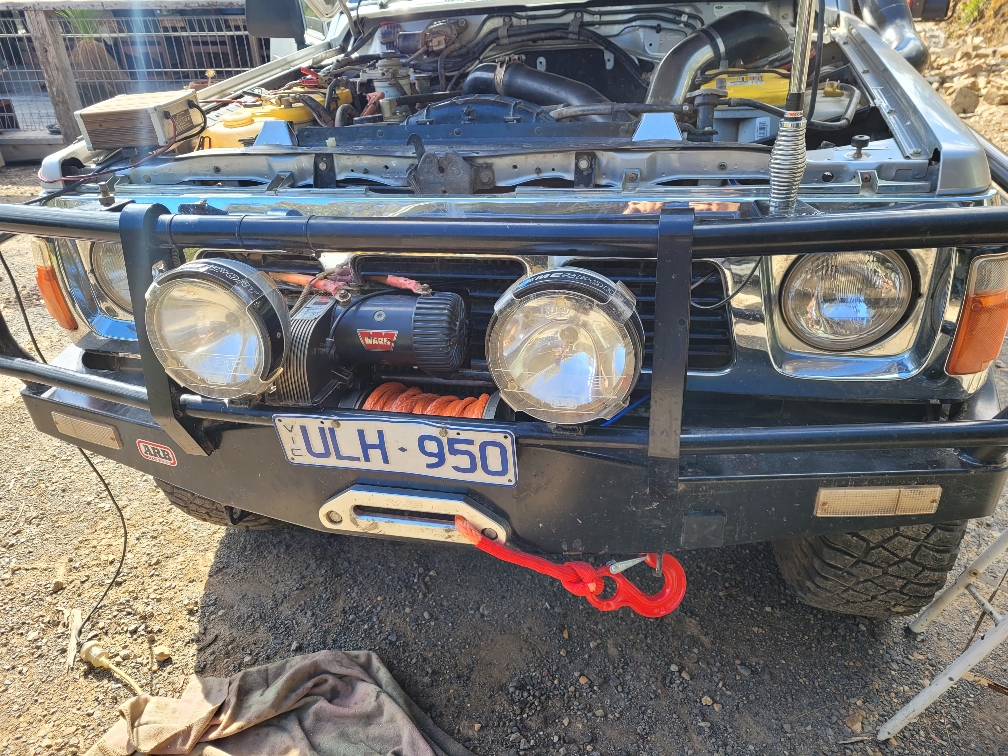

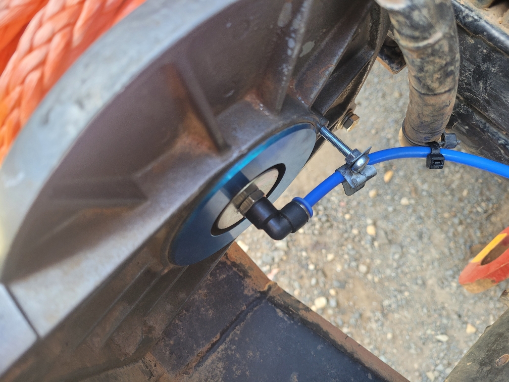

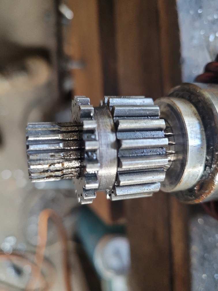

    Winch all back together not without a few dramas tho lol. . Could not get the motor out from top hat ended up drilling hole in feespool delete as that was equally impossible to get out (remember putting it in was so tight thinking this will never come out damitt). . . Anyways bit of belting on end of motor shaft out she came. . Spine that runs on bearing in freespool delete (winch gear) was flattened so explained why she wouldn't come out but unsure why the damage happened.
    Anyways fixed spline good enough, taped hole and put bolt in and and happy days. Upgraded brake shaft in and looks good, everything so much more secure than the standard warn set up. .Put winch back in car worked all good till bloody noisy and realised put ratchet plate in backwards damitt. . . Fixed that then happy days
    New rope & hook. .
    Removable dildo works a treat thought spotties might be an issue but think all good. .
    New improved delta tec clip thingy should hopefully be a bit more durable than before. . .

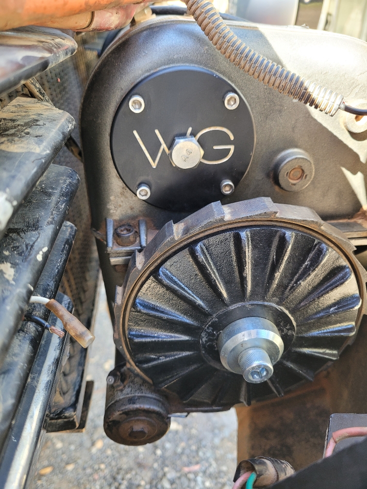

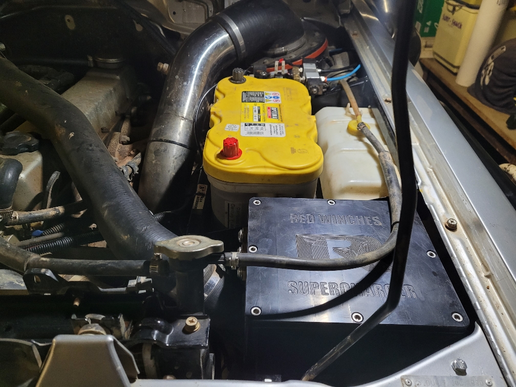

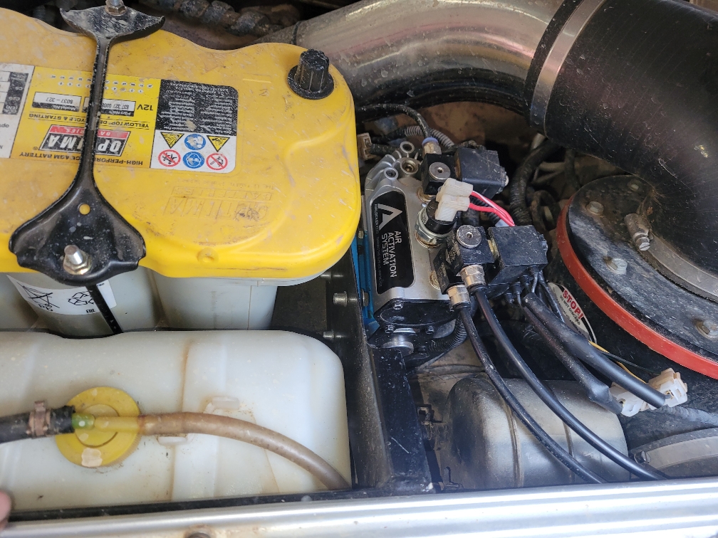

    GQ back in the hills after a bit of a birthday party at the auto elec and workshop. . List of things fixed as follows. . . Had parasitic draw tracked down to faulty alternator which I need to chase up and replace as is brand new but at least know what it is. . Installed lift pump (Carter). Was thinking optima batteries both just over a year old were knackered but with new big earth strap is cranking of its head now so very happy. Pyro fixed ( needle was off chops all over the place). Fixed battery monitor not showing imput from redarc BCDC (neg wasn't going through shunt simple fix but needed fresh set of more professional eyes). Think that's about it in the auto elec department she's petty sorted now (apart from swap alternator) so ready to put in Redwinch supercharger soon. . . Picked up from there then dropped @YV4WD for new front wheel bearings, stub axles and uni joint in rear shaft bloody Tassie mud damitt. . Think she's about ready to enjoy now

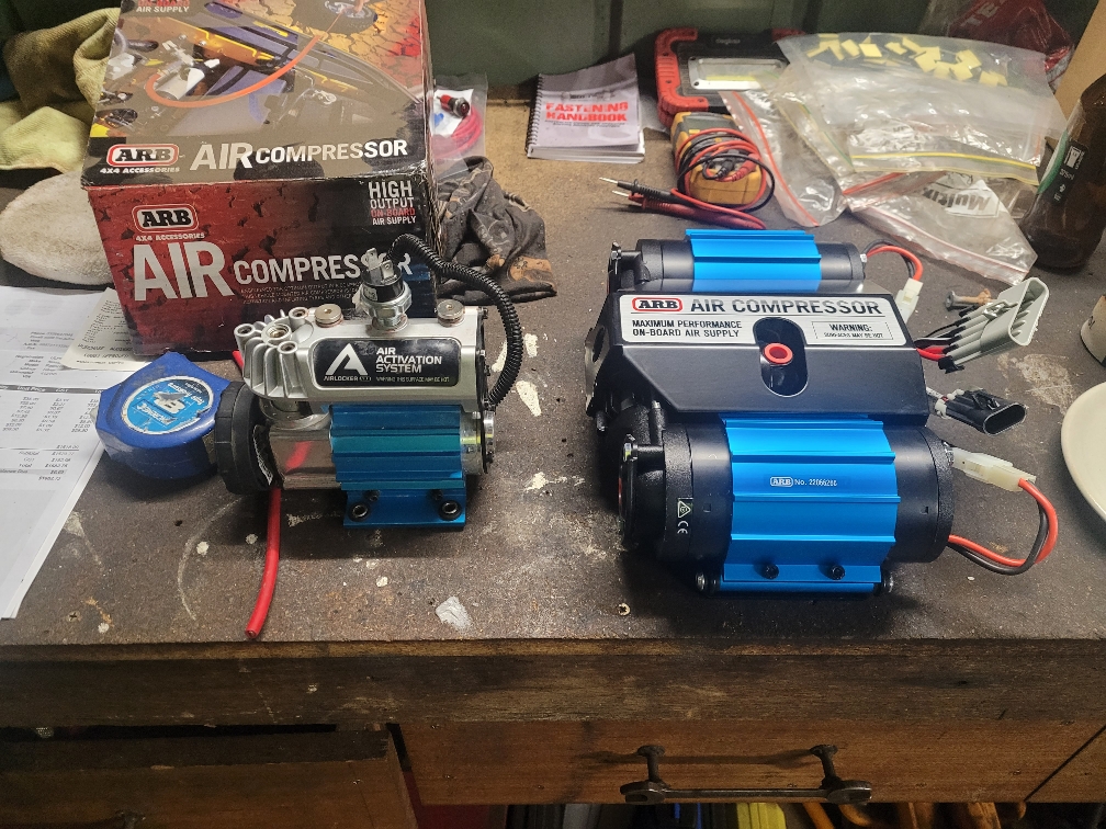

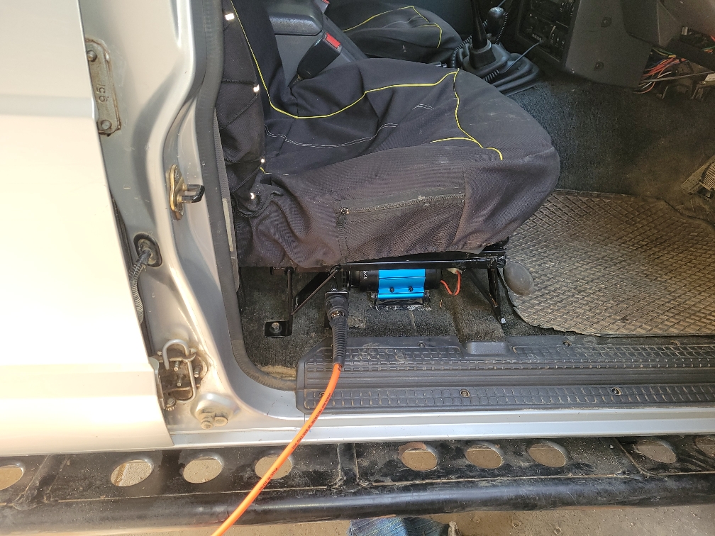

    So after last trip away ARB single compressor which is pretty old and done a heap of work gave up on life, luckily held on long enough to run lockers and winch freespool for a marathon winch halfway up Mt Selma. Decided to upgrade to Little one to run lockers and winch freespool and double for tyres. . Long time coming as usual but all installed now. .
    Old single was mounted in corner and as locker compressor nice and compact managed to move that to back of aux battery tray and fit in red winch supercharger in corner spot. . Fits prefect was meant to be lol. . .

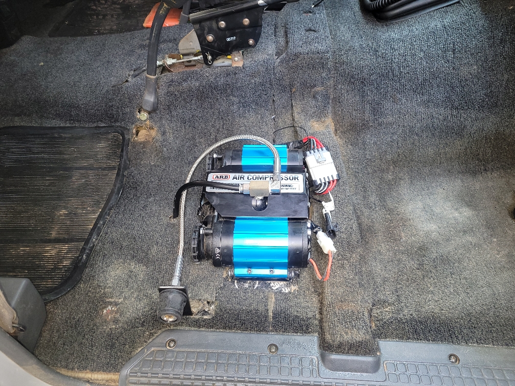

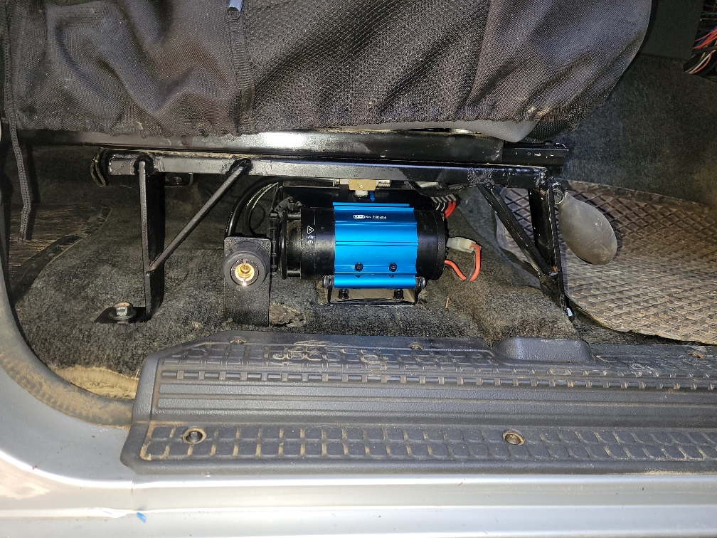

    Put double under front seat and fits a treat

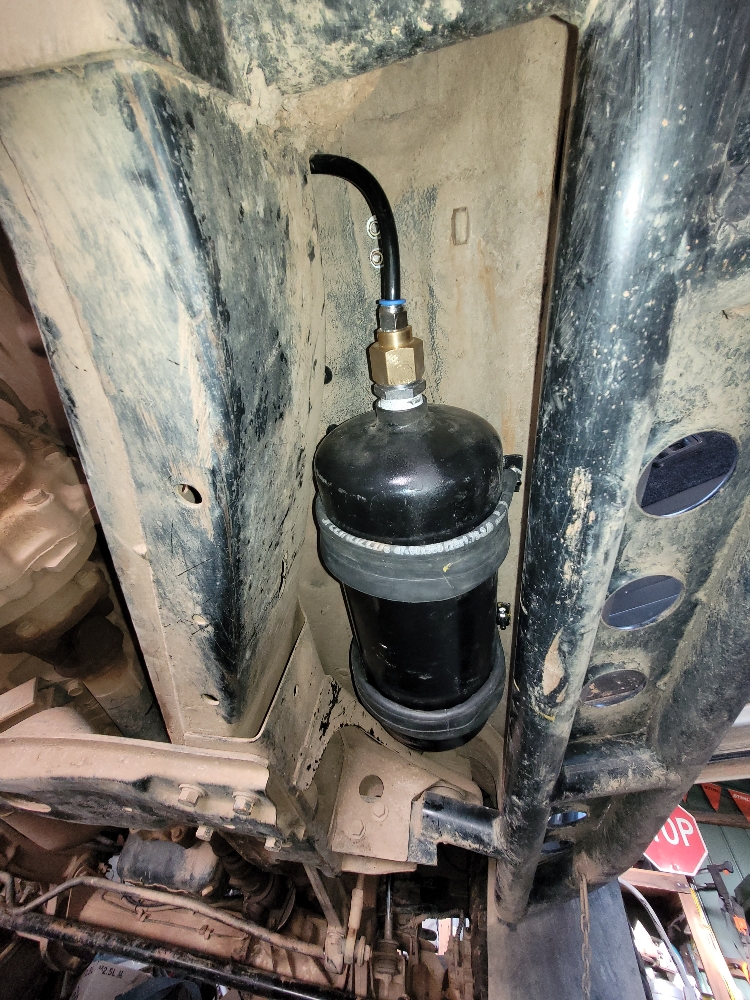

    Used old fire extinguisher (cheers Daz) for air tank directly under it. .

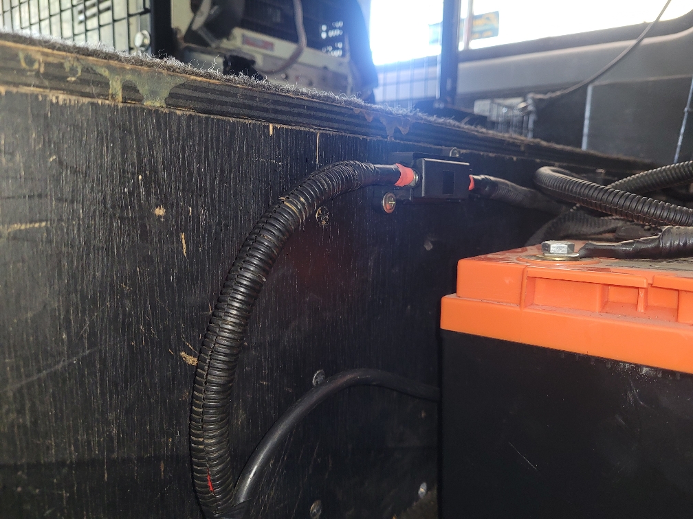

    Got rid of most of the ARB loom and ran 6b&s through midi fuse from lithium in the back. Apart from that you can just switch the compressor from the purple wire going into it. .
    Gave it a little go and seems like it will be a beast. Certainly wouldn't want to run lockers off it if mounted in cab, she loud and also may double as a masage seat on those long and lonely trips

    I see you have the intake filter at floor level. I ran a hose under the carpet and door trims so I could mount the filter in the rear quarter panel trim card. It made it a hell of a lot quieter as the intake is so far from the piston. Now there is less chance of flooding the compressor.
    I have my twin under the pax seat. Not that loud. Plus Catherine gets a kick out of the under seat vibes! Lol.
