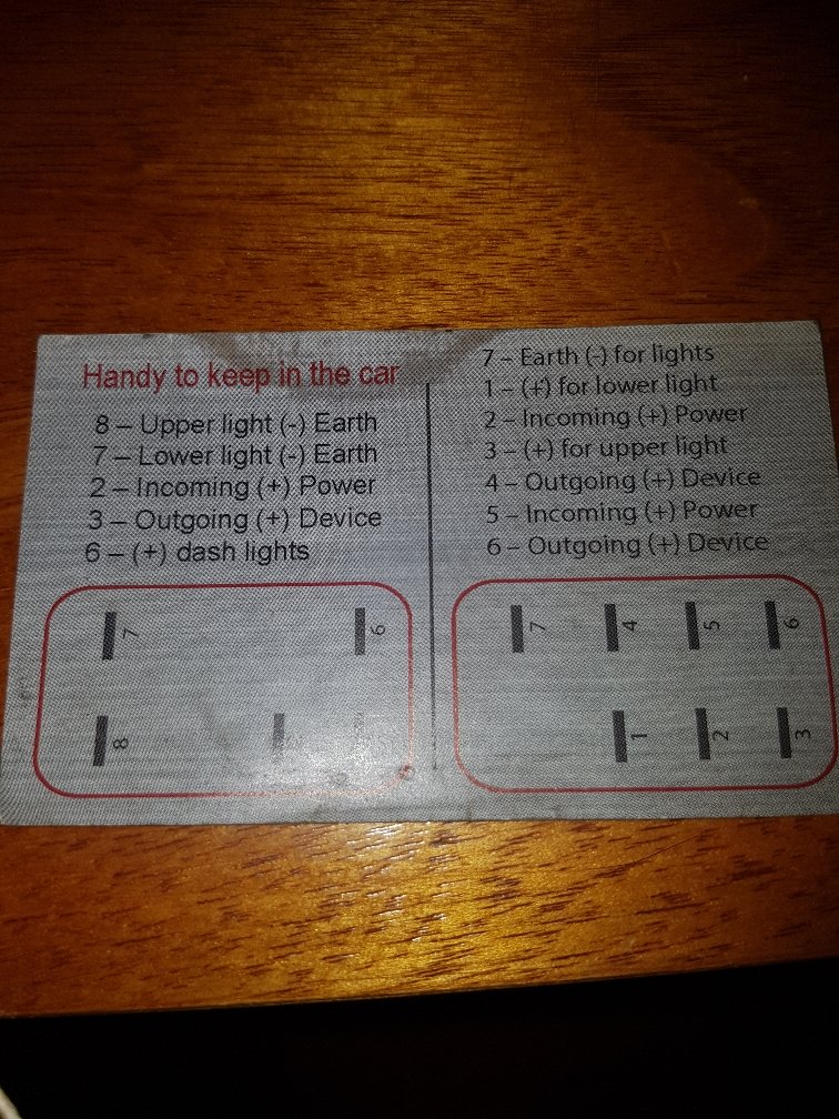

    So I’ve pulled the dash apart and will start on the in cab wiring of the isolator and winch in/out switch.
    Looking at the back on the in/out switch there’s too many pins, 7 of them. Lol. Anyone have a wiring diagram for this part?

    So now I have to wait until ARB get my bits in. I hate waiting....
    Hopefully this helps. .
    Thanks.
    Just gotta work out the schematics of it all. Do I need to use any relays? Also I'm thinking of getting some small 2mm, or similar, 7 core trailer wire and use this as a loom to out of the cab. I should need anything heavier you think?
  13. #349
    4,599
    10,432
    Yeah think I just sketched it all before I did it to get my head around it all. Trailer wire should be fine, don't need any relays big solenoid does everything. Worth thinking about when you do it is putting buttons up front on the bar very very handy and also some strip lighting above the winch which picks up power fron the isolator, very handy in the dark obviusly. . .
