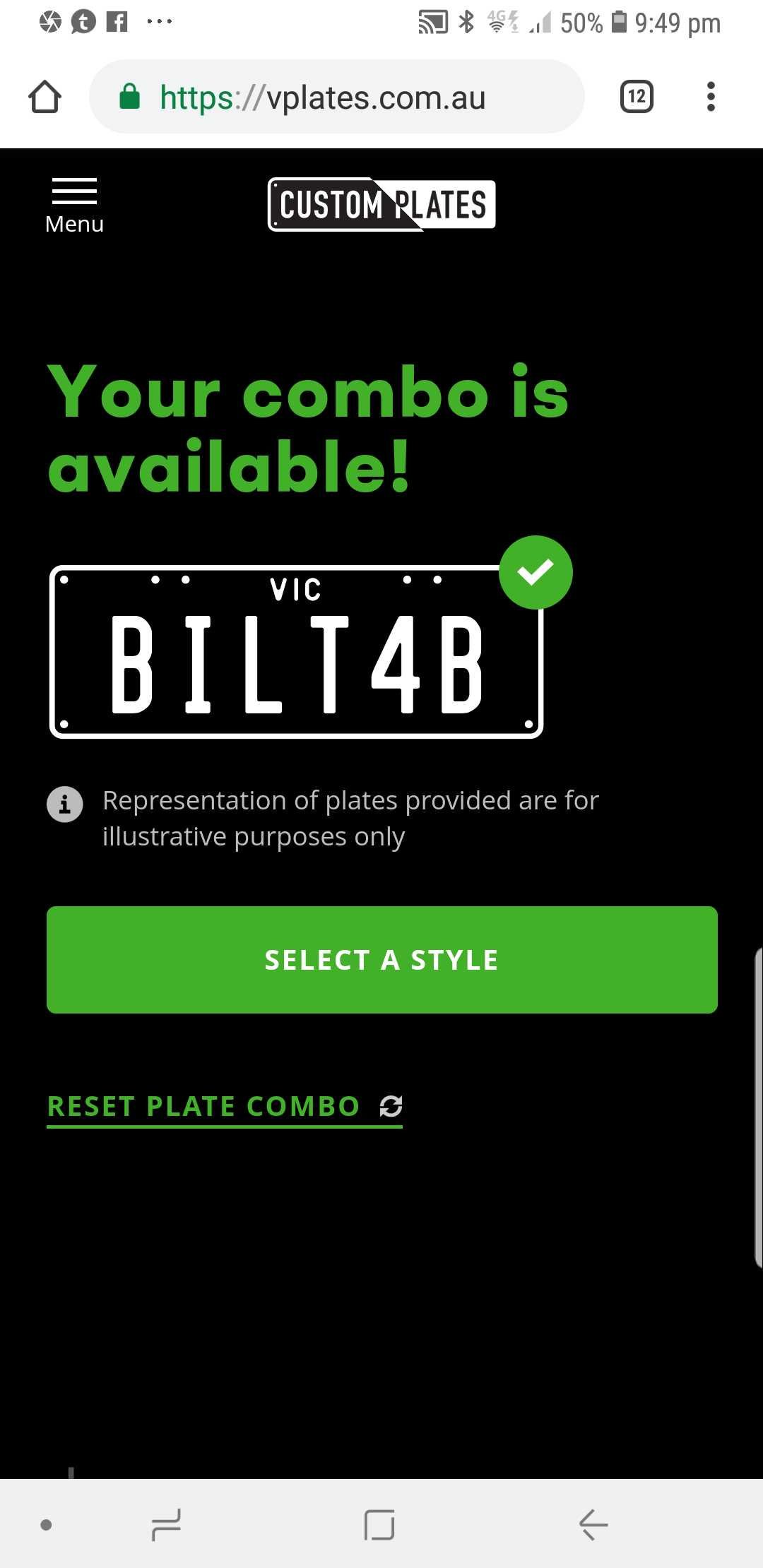

    How about
  6. The Following User Says Thank You to PeeBee For This Useful Post:
    MB (12th March 2019)
  7. #1614
    ‘BILT4B’ for sure mate, good work

    BILT4B for sure though. It would suit this animal for sure.
