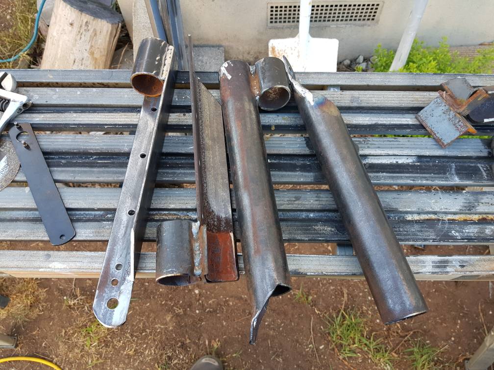

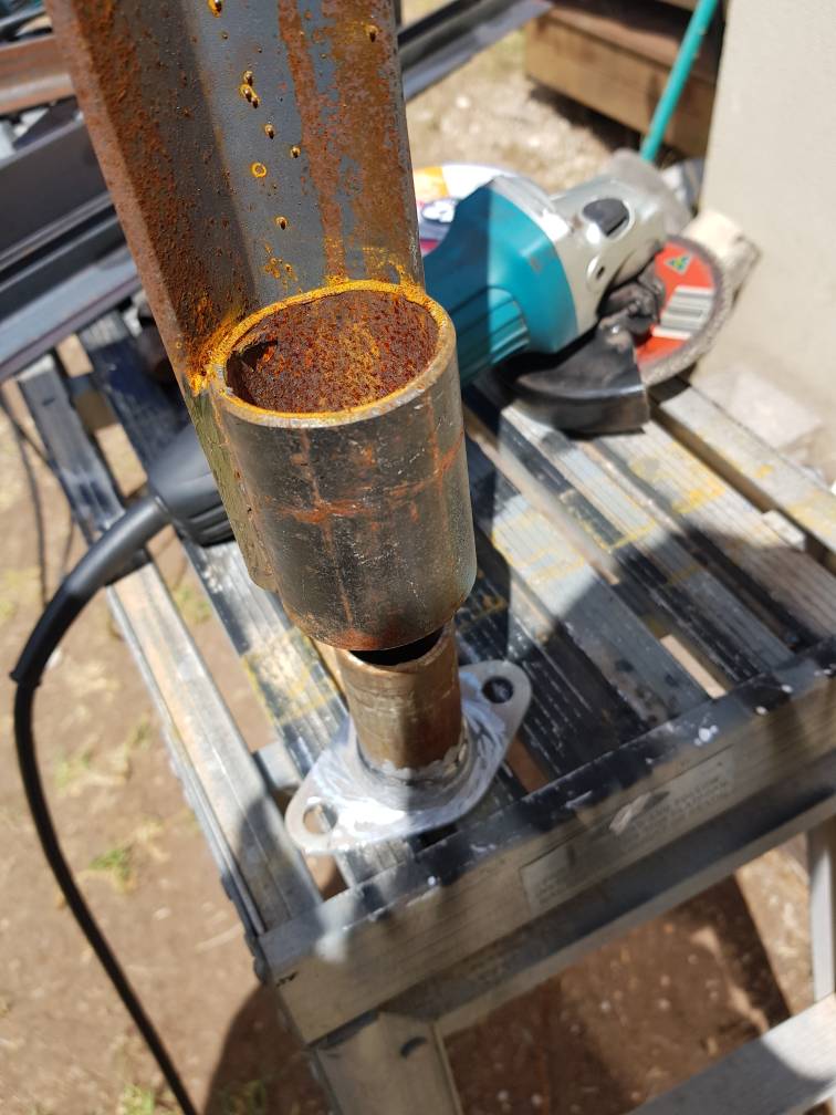

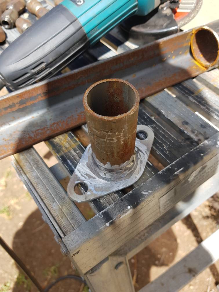

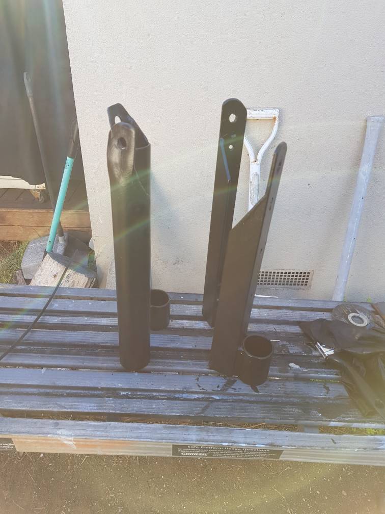

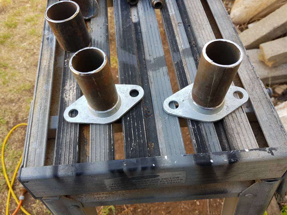

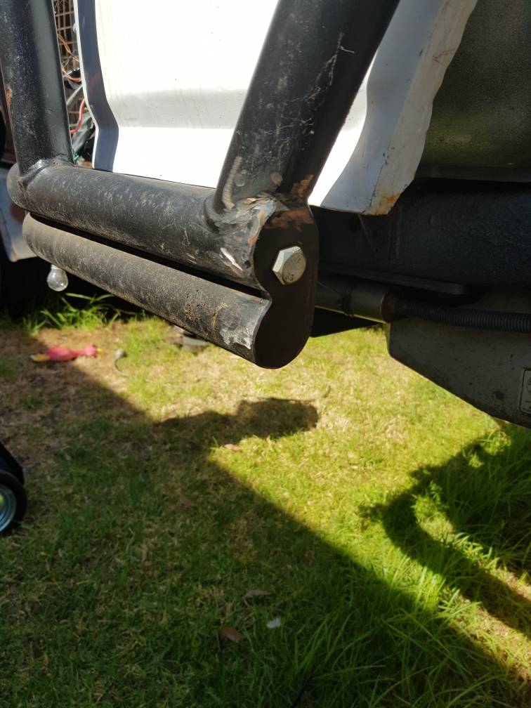

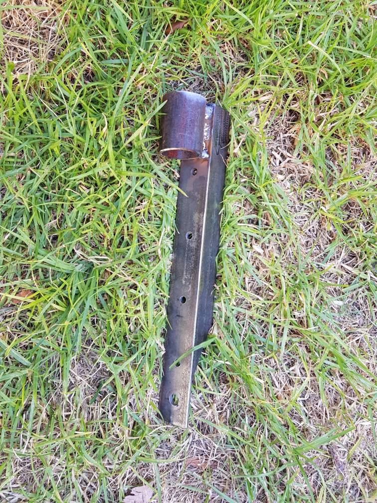

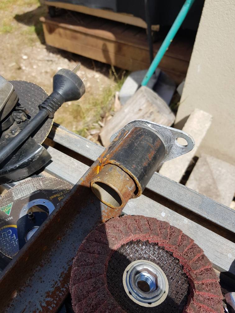

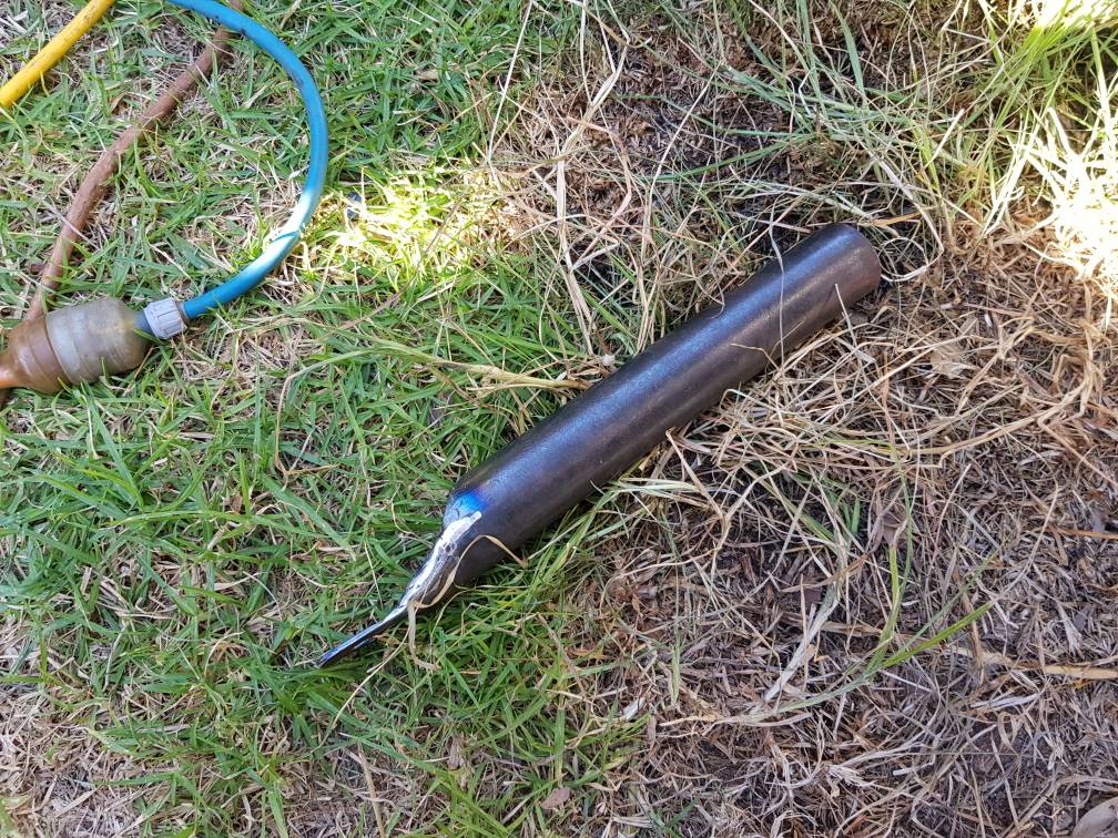

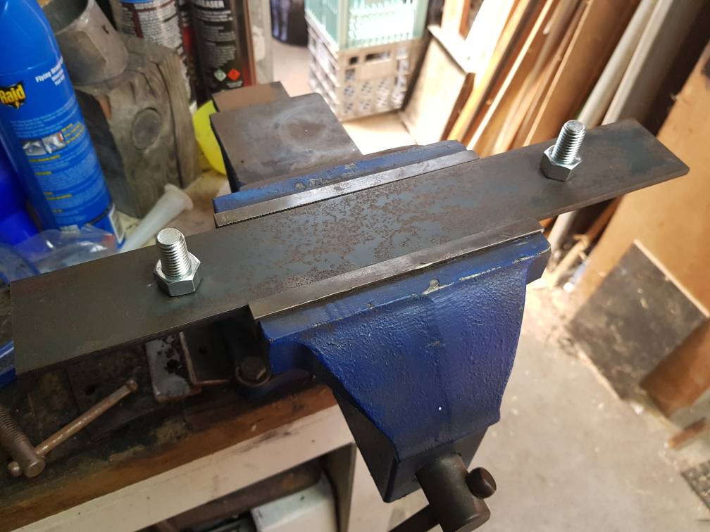

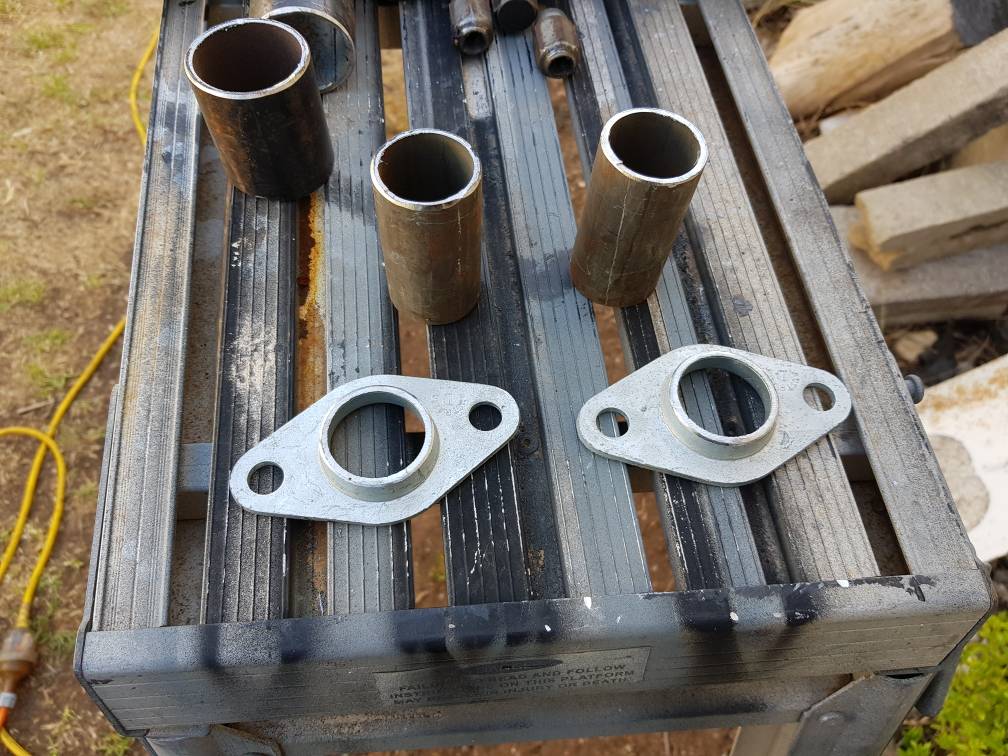

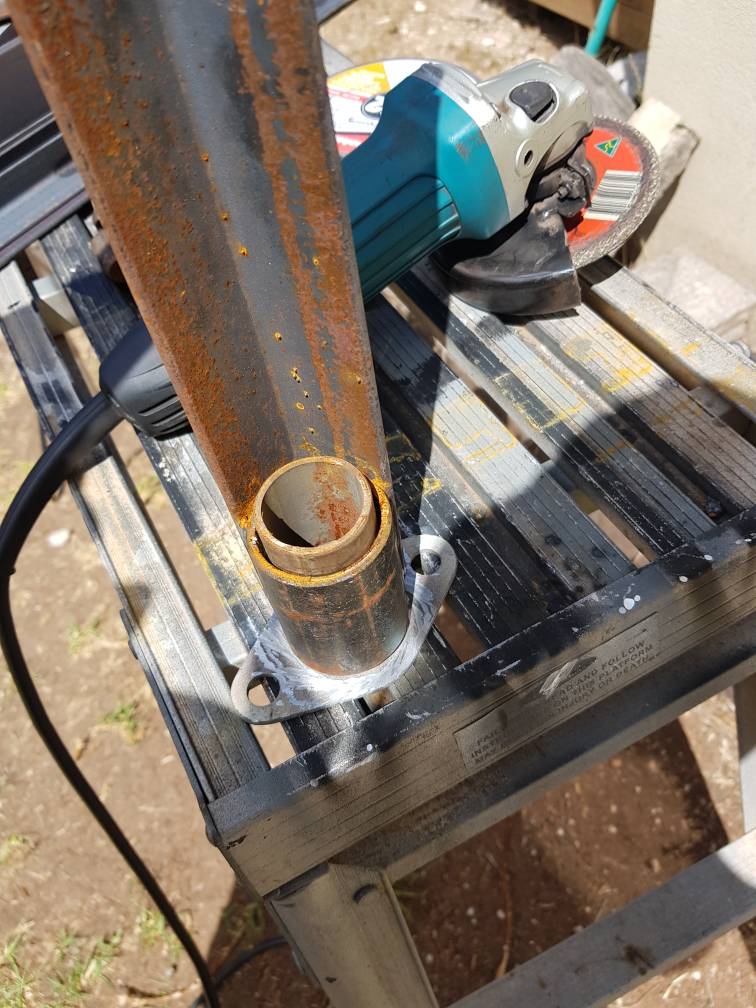

    Mud flaps. Need mudflaps but want 5hem removable. So a fair bit of thought and they will be a 1 bolt removal and a second tube will go in to act as a brace when there is no mudflaps in the bush. Going to be awesone.
    I had to cut this off and finish it off.

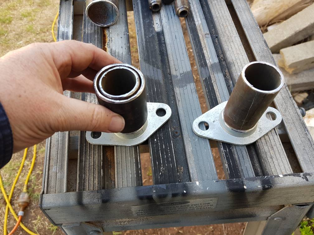

    I made the end plates and welded captured nuts in place
    All painted up and ready for the mudflaps.
    So these plates will be welded to the chassis with the stub of inner tube.
    The outer ring is welded to some angle iron to hold the mudflap.
    Coming along.

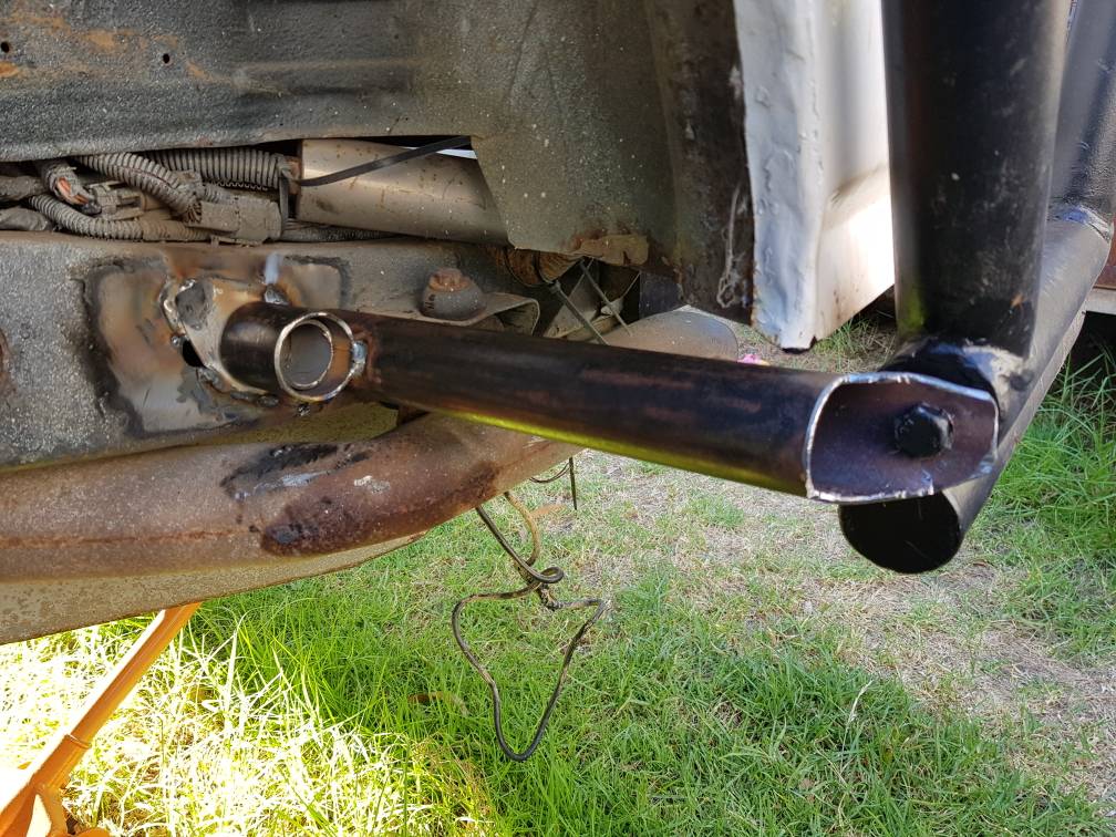

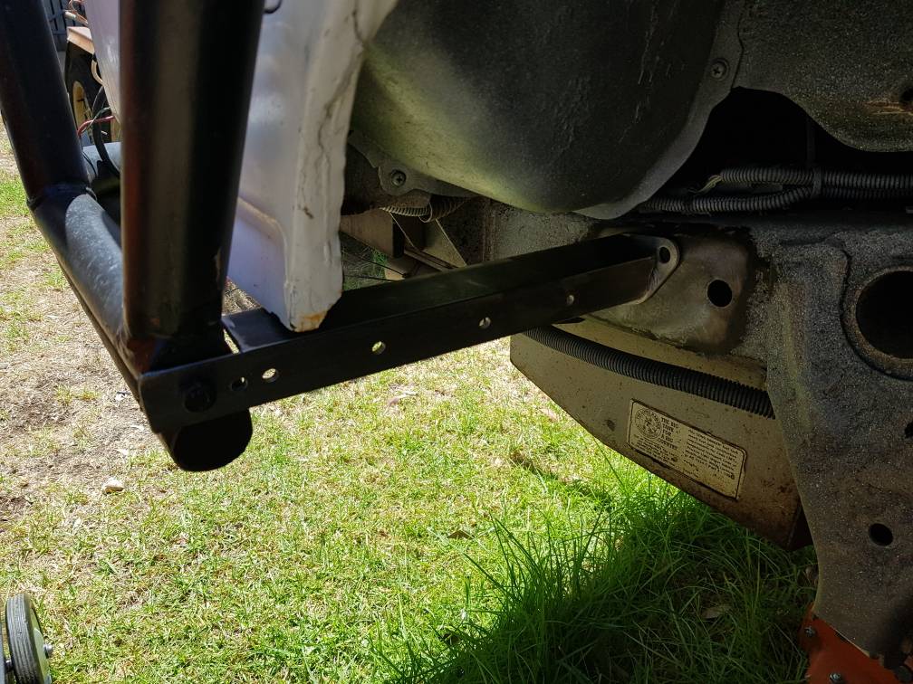

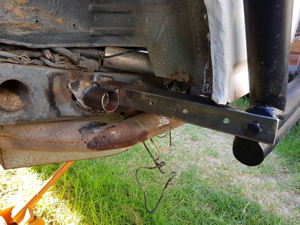

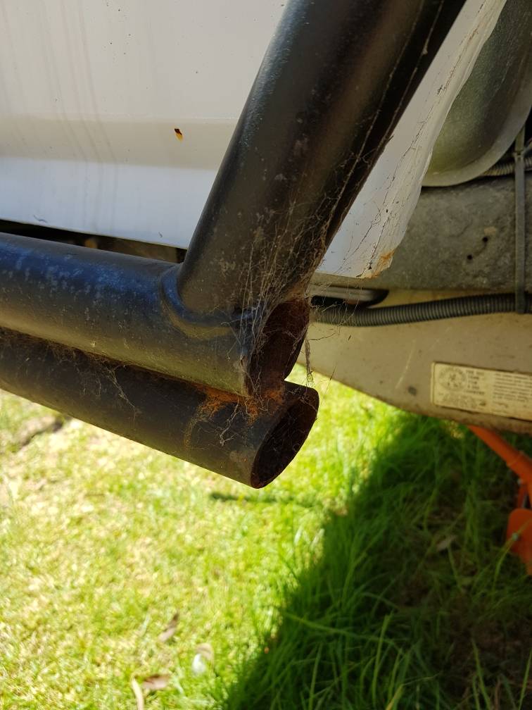

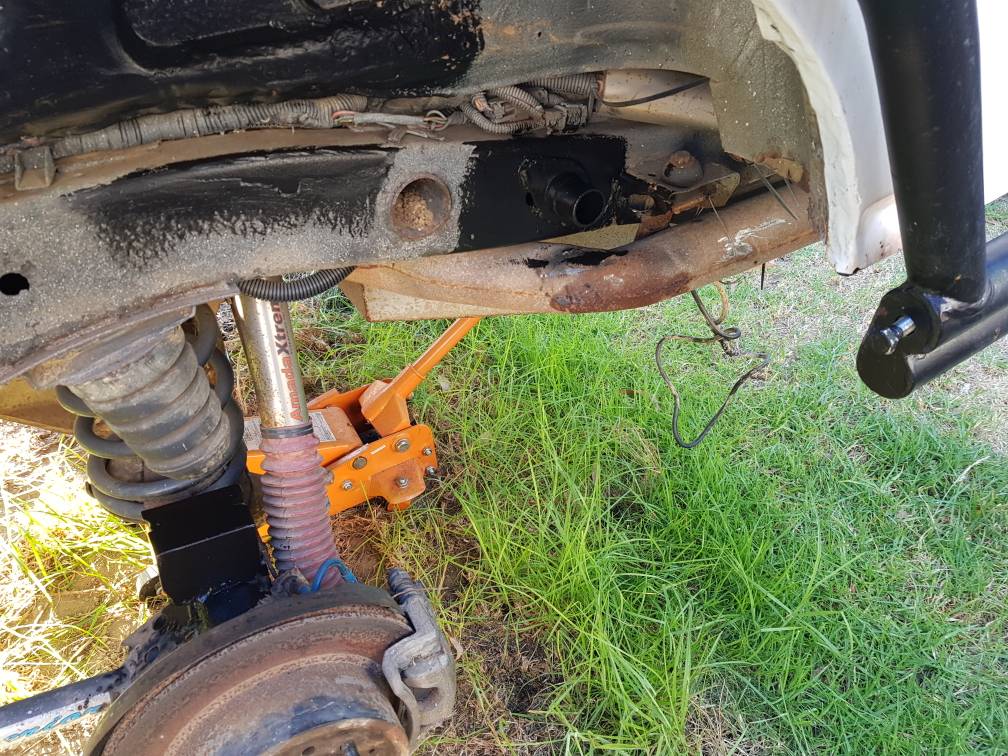

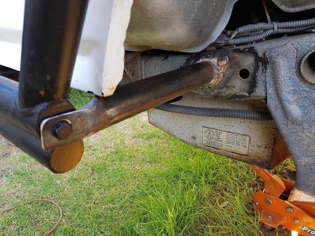

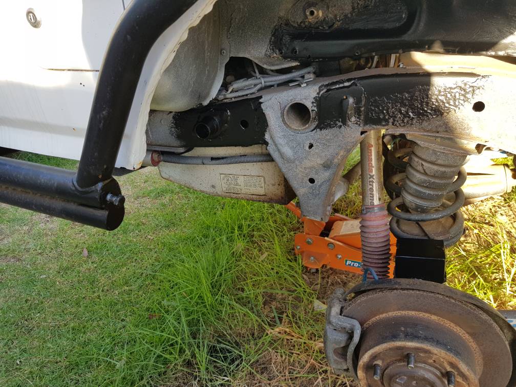

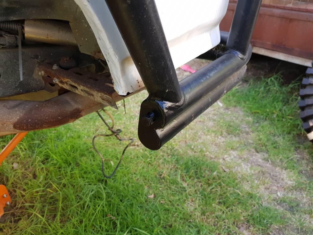

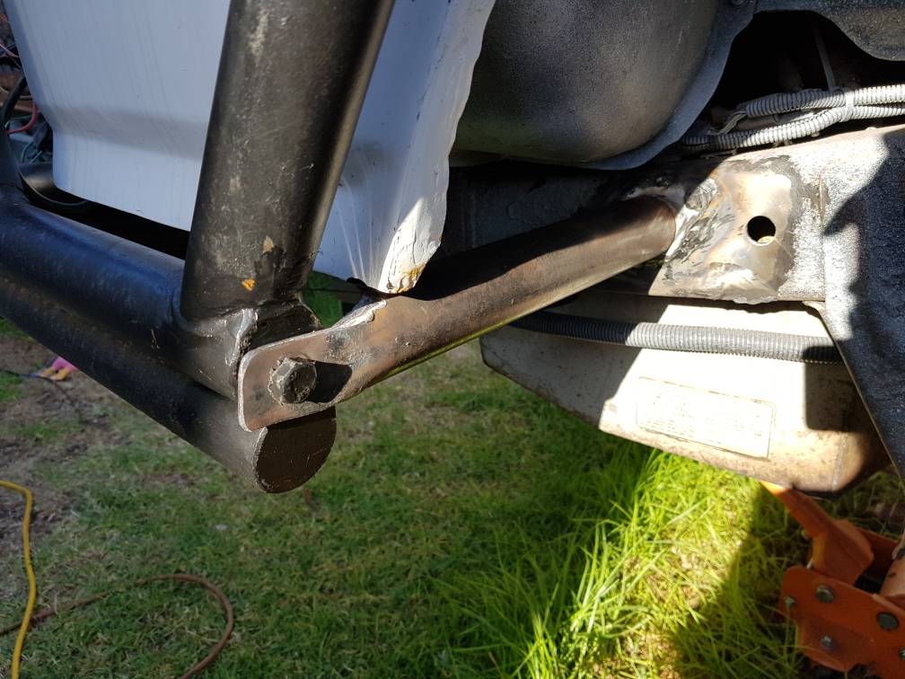

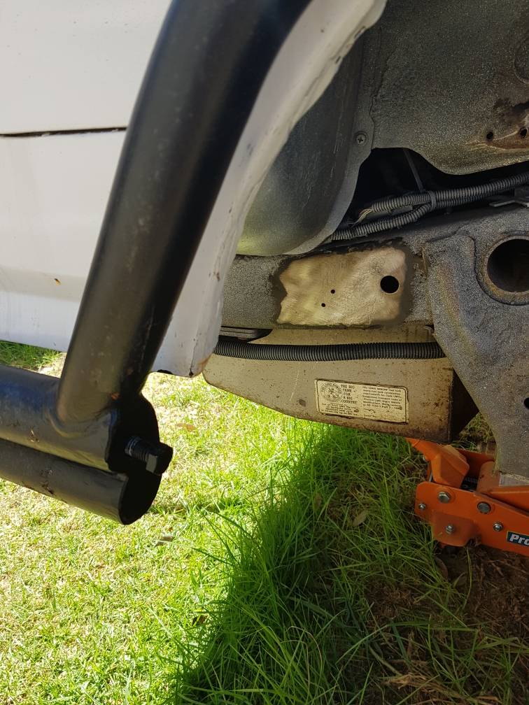

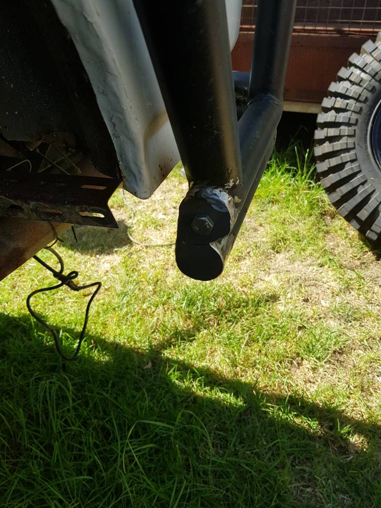

    So i got most of it done today. Just need to mount the rubber conveyor belt mud flaps and we are good to go. 1 bolt removal achieved.
    The passenger side was a bugger because of the factory exhaust mount in the way damn it. Flipped and sorted.
    Removable.

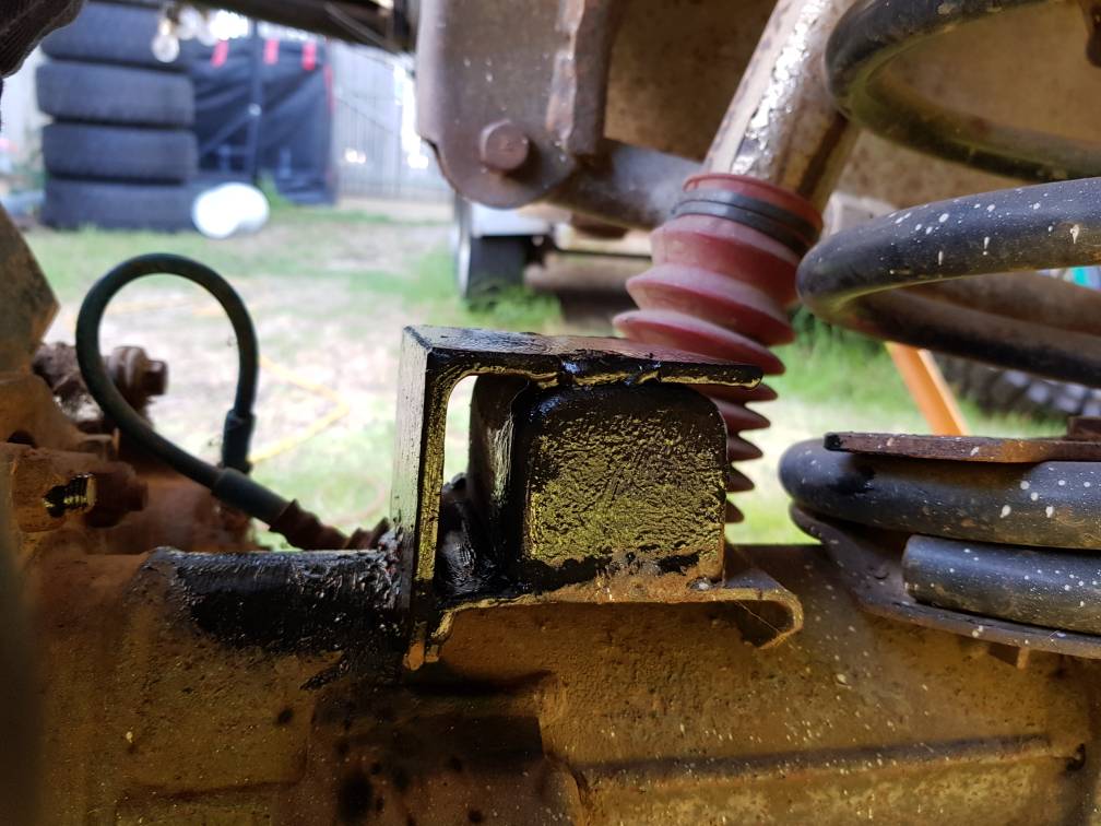

    So i decided i wanted to make an alternate brace bar to mount when offroad so a side hit will have some support.

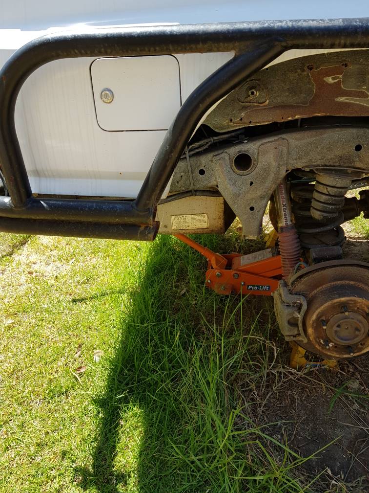

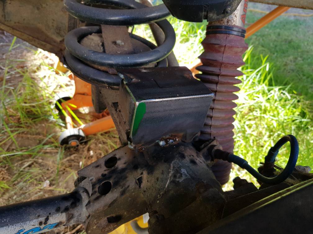

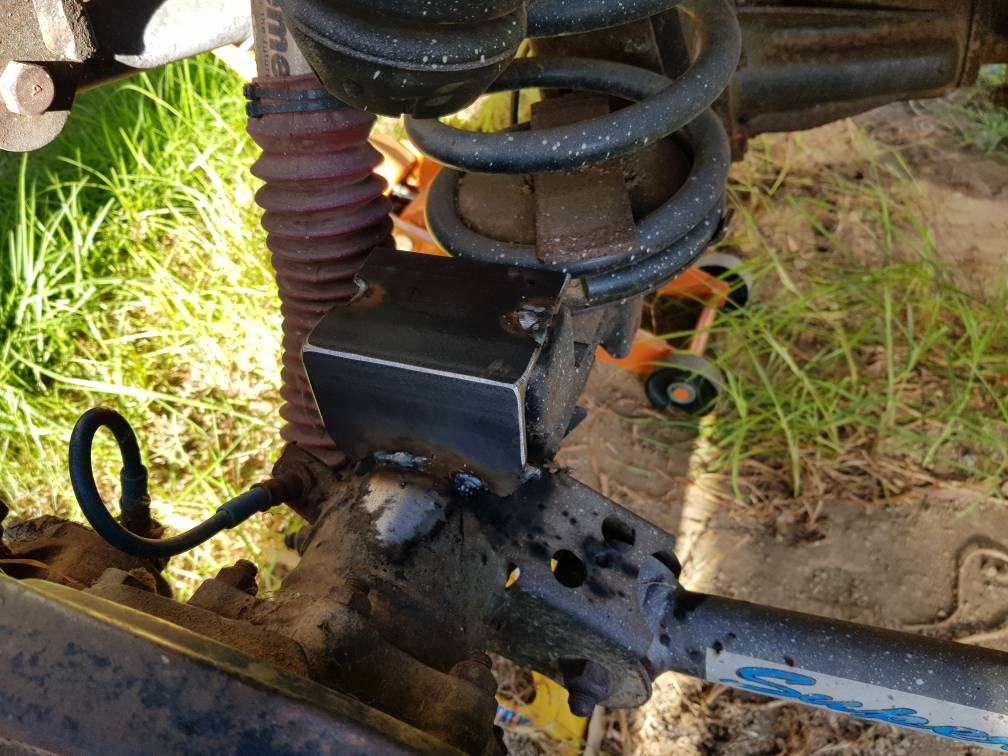

    While i had the welder out i also made the bump stop plate bigger as when i e tended them years ago i made it too small and the bumps slipped off the side.
    Easy fix while the wheel was off.
    90x90 angle welded on top of the box i welded on last time.
    Easy as. All painted up and ready for rubber matting.

    Sweet, how will the exhaust go scrubbing wise with the 37s. . Looks like they scrubbed a little on the bend, mine do with a bit of flex. . Pretty easy fix if need be i guess. .
  9. #1586
    15,482
    12,377
    Thanked 13,637 Times in 6,654 Posts
    334 Post(s)
    Yeah the 37s are n some bloody Huge Offset rim so i dont think it will be a drama but will keep and eye on it.
