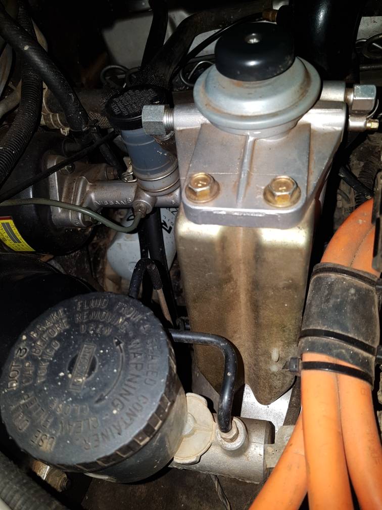

    Hey guys,
    So I have searched the forums about this but haven't had much luck finding it. I have a td42 na gq and I'm looking at getting the patrol docta bonnent entry snorkel and airbox package.
    Obviously I have to relocate the fuel filter, vacuum lines and clutch bleed hose and maybe a few other things.
    My main question is how do I relocate the fuel filter to the drivers side to fit the airbox, or can I put it somewhere else?
    Has anyone done this?
    Thanks!

    Should be as simple as unbolt it, relocate it to where you want and then extend the rubber hoses to suit, or am I missing something?

    Hey mate just need the bracket off a GQ that mounts on that side. Think the later model TDs did as well as the RD28. Will bolt straight up to factory holes. Also need the brake line of the master cylinder as it bends around a little sharper. Makes more sense having it on this side as it goes across the firewall then back to the pump with the firewall mounting position. See pic below moved mine across to make room for airbox too.
    Bracket is also on the ZD's too...

    I brought the same bracket as above, can still buy them new from Nissan, I paid about $80 for mine brand new
