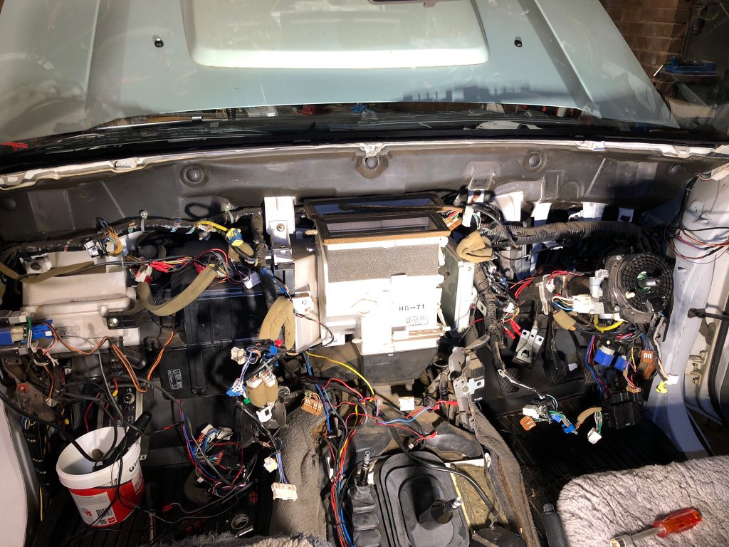

    You sure that wasn't the A/C evap you are thinking of. As I have done mine before and that pretty much all I had to do. The heater box is located centre of the dash right above the transmission tunnel.
    Edit : See link for GUIV removal. Same as mine.
    http://www.nissanpatrol.com.au/forum...re-replacement
    As I recall, initially it was thought that the heater core was leaking and I went to an A/C - Radiator shop, where they removed all the under dash fan unit assy, and ducting up to the center console.
    They then removed a fin cored unit that sat up in behind the center console with two flange pipe connectors to it. Thought this was the heater core? At this stage this core was inspected and deemed to be serviceable and was reinstalled as it was a genuine unit. They then used an UV light and identified that the leak was A/C fluid and did a service on the A/C unit (maybe evap?), fitted new o-rings /seals and re-installed. Then they pressurized A/C unit and leak was still present and it was discovered that the o-rings at the firewall flange A/C joints were deformed solid and were not sealing.
    This is as I recall the event and am very prepared to be put on the right track as it is fairly unfamiliar territory and consider correction/guidance to be a part of good learning.. Thanks mate

    Yeah I had a slight hint of rage flush through me when I first read it. Then I realised it was a/c evaporator that comes out easy. Hopefully tonight I'll get the lot out including the heater box.

    There’s the bloody heater box! Right in the middle.

    Mark, while it's open install a Cabin Filter. Just did mine and amazed what a load of crap/dust/leaves were in there.
    Quick vacuum and all good, here's the link and less than half the price of RYCO or REPCO
    http://www.brettstruck.com.au/Listin...0&searchType=2
