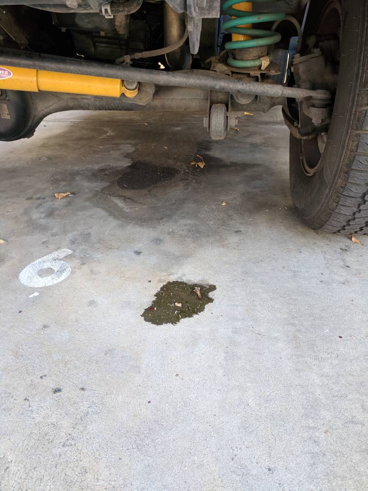

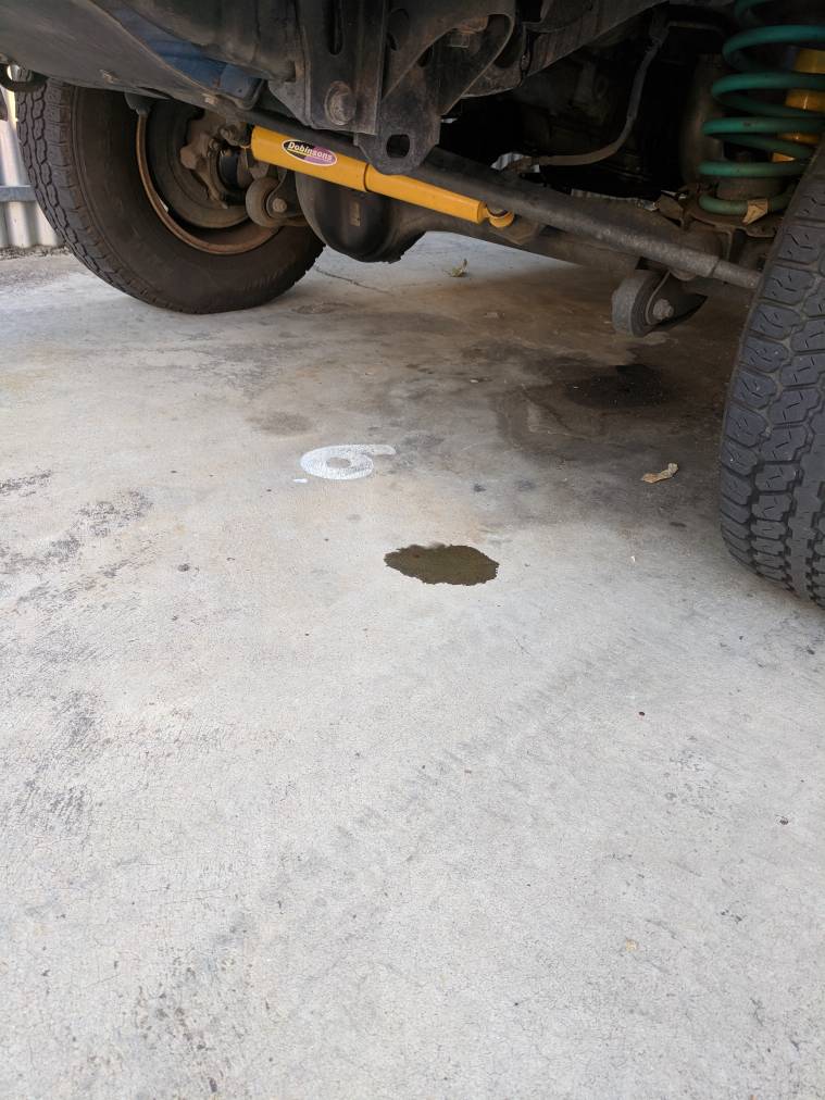

    Finding some coolant under my car but i'll be stuffed if i can find where it's coming from (yes i know.. the cooling system) Looks like it's leaking out of the chassis rail.
    I recently had this exact same problem!!! Turned out nine was from a slit in one of heater hoses, wasn’t easy to spot straight away and a PITA to replace lol

    Mine is coming from the front somewhere..
    This morning it's pretty much all dried up so NFI lol

    Check your overflow bottle assy. I had a small leak and it took me a couple of years to find it - bottle had a tiny split on the back side on a seam.

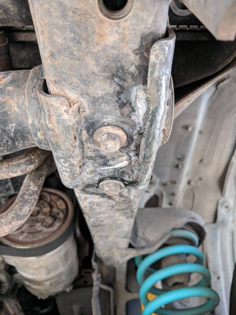

    i was surprised to see the actual spring seat was split too! Damn it.
    Yeah, I was surprised to see that as well, odd I reckon.
    I've just replaced my rear coils with lighter ones as I don't carry much stuff in the rear 90% of the time and was concerned that stiff coils wouldn't compress enough and put too much stress on those mounts.
    Hey mate is yours a 3L CRD? They have a common front timing cover coolant leak. Mine had it. And it was a bitch to diagnose !
    I don't think this is your issue.... BUT ....
    When you said, that today it all dried up, I brought back memories for me. lol
    Basically, when motor is running / hot, no leak.... If i sat the car untouched for a day or so, leak appeared. Basic theory, when motor heats up, metal expands, sandwiching the timing cover. Motor cools down for a lengthy period, metal shrinks, small leak occurs.
    Mine mostly accumulated at the bottom near the A/C. But sometimes I found it sitting under the passenger front chassis. Later on I realized it was making its way along one of the hoses and down onto the chassis.
    Here is more threads on it...
    http://www.nissanpatrol.com.au/forum...e-timing-cover
    http://www.nissanpatrol.com.au/forum...-leak-CRD-3-0L
    Mines a DI and 99% it's not coming from the motor. Just went and out to visit my mate Dan... Dan Murphy and I was greeted by it leaking again ffs.. header tank seems to have lost a little bit of fluid... So going with that. Will look into it more tomorrow once it cools down, and I have Turkey's to drink now 👌
