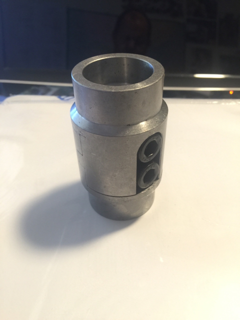

What is this join you are talking about?
How is it done? I like it. My rear scrubs are welded from sliders to rear bar and the slip joint to the front bar is above the wheel arch. Will be a pain in the arse when I go to pull it off to replace the front guards and fix the rear.

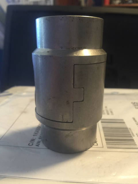

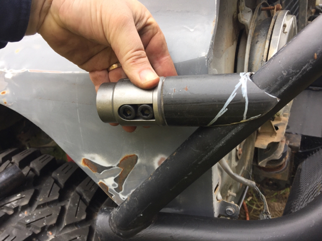

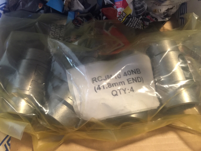

Ohhhh! Look what the Postman delivered!!
Weld in Camberg Tube joiners! Noice!!!
@Dhuck Camberg tube joiners is what you need they are Awesome mate. They have a keyway to lock them in position then m8 bolts lock them up.
Under $40 each

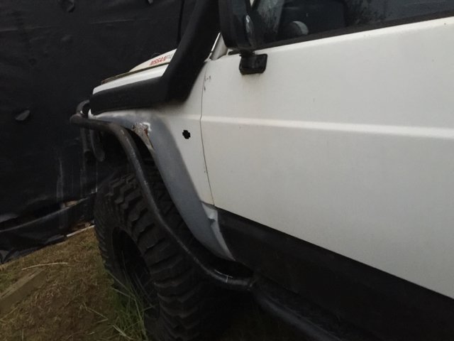

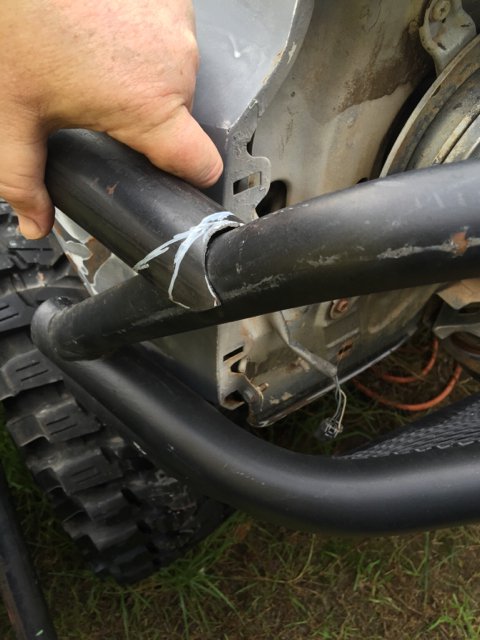

@Dhuck here I have used them at the front of the brush bars, I also fitted them to the start of the rear scrubs to join to the sliders.
