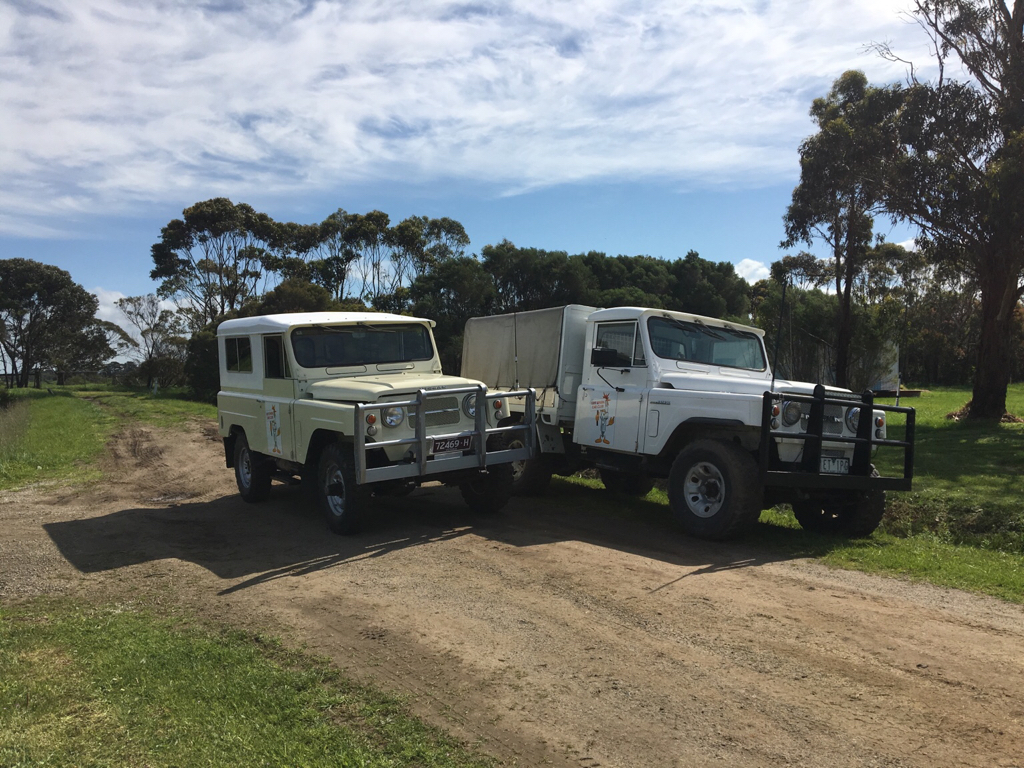

    Really?
    Where are the pics?
    It doesn thave something like a turbo 350/400?
    Yeah. A 400. He had it at ABs last party.

    It's the ute with the V8
