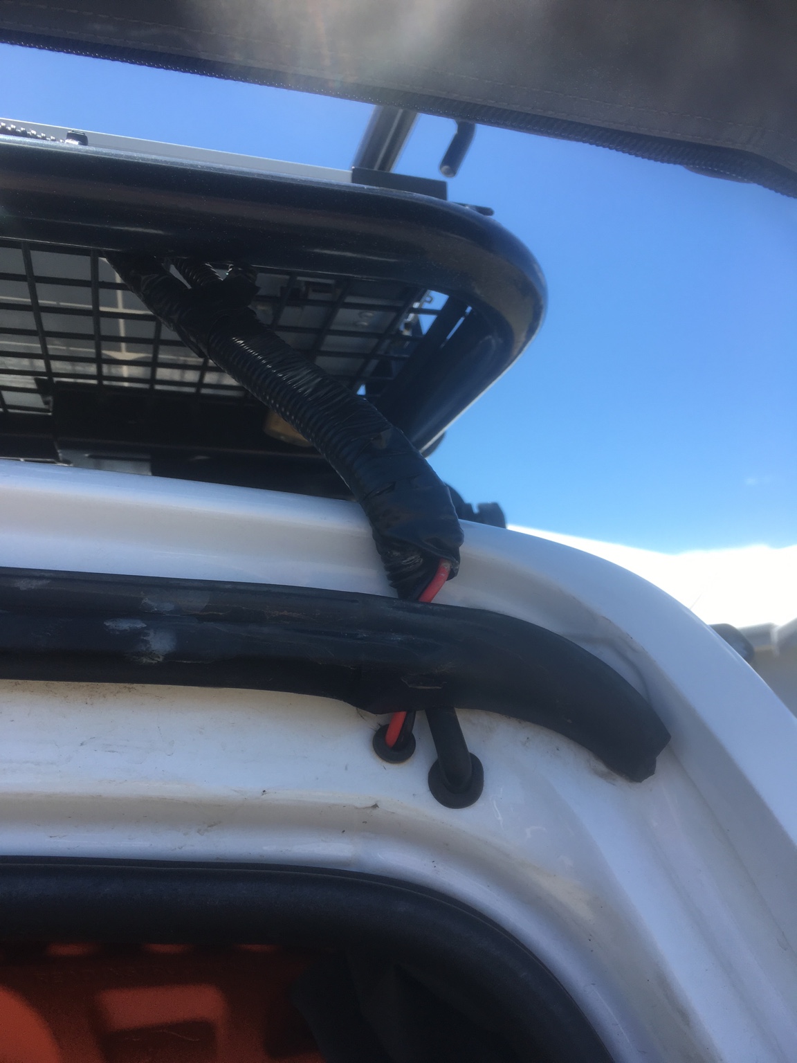

    I know you said without drilling but this is what I did. Never had a problem with water getting in.

    Gland fittings..... ive got 2 on my roof and have never leaked or rusted if installed properly. You can also use bulkhead detchus fittings but thats $$$$
