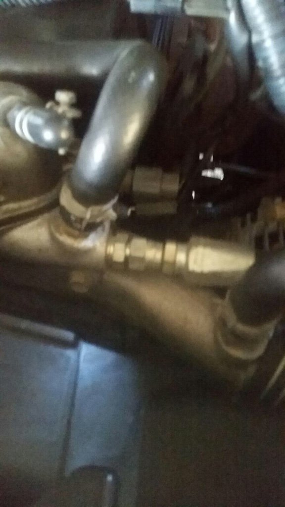

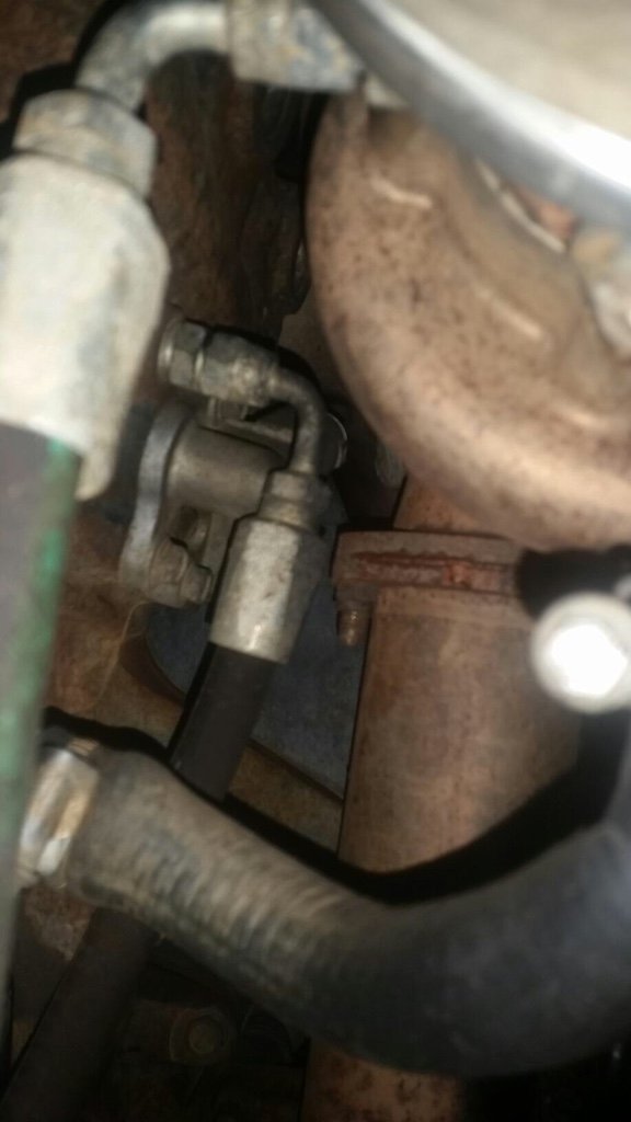

    Yeah I got this pic off Matty the other day and will show it to Pirtek for the Oil Return line
    And I like the make your own option for the water return like this, again from Matty.
  2. The Following User Says Thank You to MudRunnerTD For This Useful Post:

    Yeah I got this pic off Matty the other day and will show it to Pirtek for the Oil Return line And I like the make your own option for the water return like this, again from Matty. Sent from my iPhone using Tapatalk
    Thats water feed not drain. Who's car in that pic?

    Thats water feed not drain. Who's picture is that car?
    Mine.......

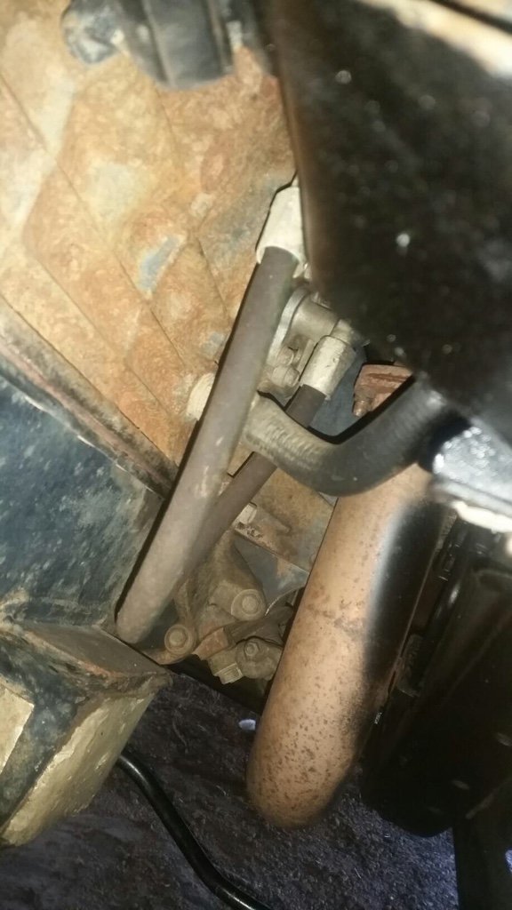

    You can see my Oil drain slightly in one of those pics. However I am using the larger frame turbo than you guys and it all sits further forward. I just used the drain hose that was with the UFI 18G I had prior.
