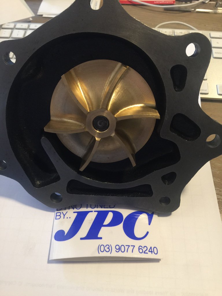

    So went over to JPC today and grabbed one of their hi spec water pumps. Looks the biz!!

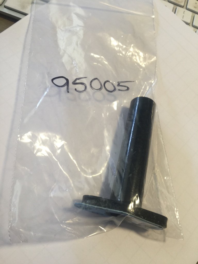

    Then stopped in at MTQ and grabbed an Oil Drain flange and pipe. Glad I did! eBay was $45 plus post. MTQ was $24 pickup. Happy days
    Note the part number of anyone is chasing one.
    Did you get the oil return hose as well?
    Why the cooling system mods?
    Hi mate, no I will try and get to Pirtek tomorrow if I get time. My company has a big account so should get s good price.
    Taking the opportunity to sort out my cooling while the coolant is dumped. It has always ran hot when towing and on the beach. Obviously the turbo will sort most of that out but I see the benefit of the water pump. The engine has done 270k so I'm ok to swap out the water pump regardless.

    Did you get the oil return hose as well? Why the cooling system mods?
    I agree with Matty getting that hose Dazz. I got a standard hose from Pirtek and it wasn't great.
    Hot as in coolant or pyros?
    I got Andy to put on a Flexi hose but Mattys one would be good if you can.
    Both. Alway bounce off the top end of my Pyros but the water temp rises to hot on a big long hill climb towing and on the beach.
    Ok. What is the condition of the current equipment? I have never really had engine cooling issues apart from an externally blocked core but have always maintained my cooling system well. Do you still have that rubbish egr hooked up?
