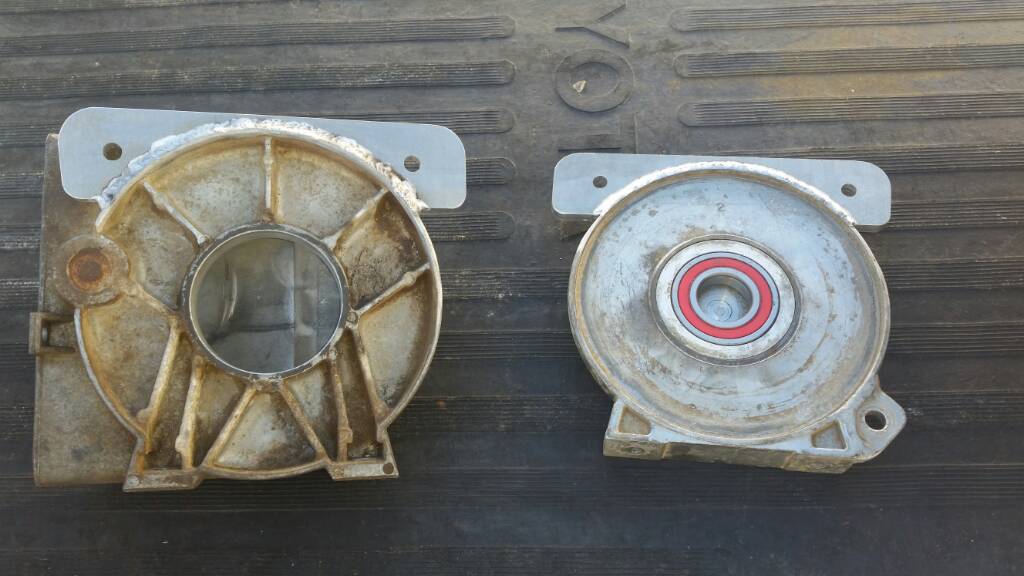

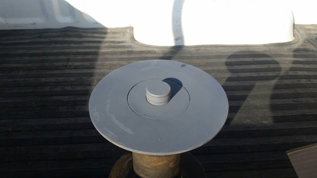

    You can actually buy an extended drum without the freespool. Without the freespool you could make your own actually. Just cut and extend the drum centre and reweld. With the freespool you also get a roller bearing in the drum end (I had this already and it's now fitted to ABs (he did ok )
    @Winnie how much did you pay for your bearing end plate mod? Got any pics for @MB

    15,847
    7,303
    I paid $50 to get my drum modified, I bought the modified end cap with the top hat and paid $100
    I'll chuck some pics up this arvo.
