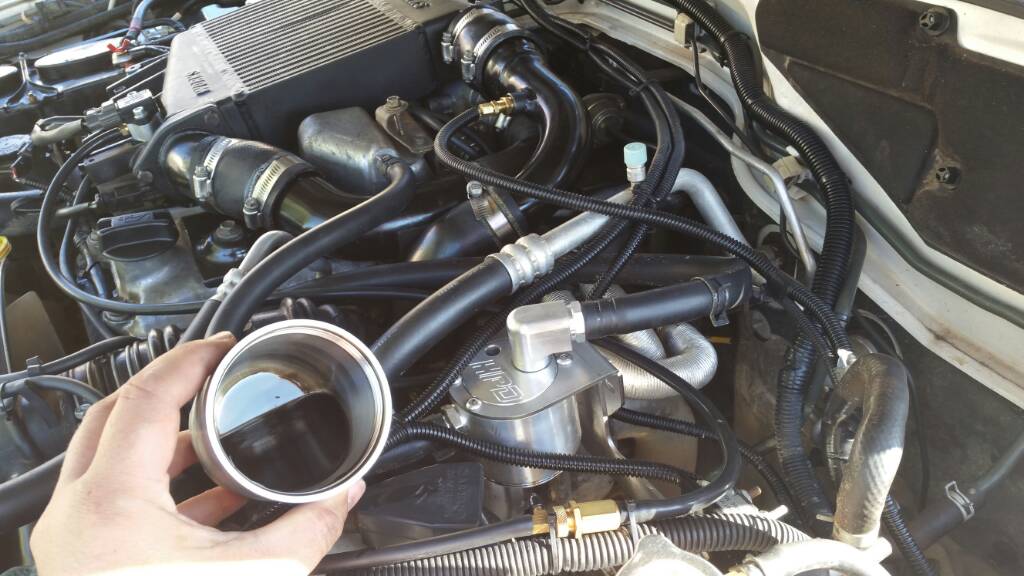

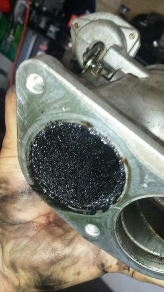

    Frm this...
    To this...
    Sent from my SM-N915G using Tapatalk
