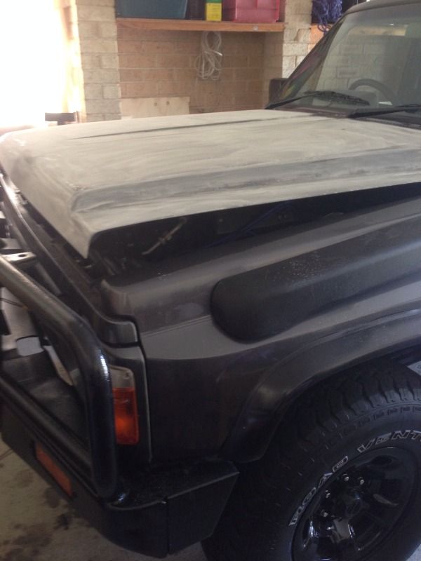

    Bonnet had a few small dents but that was sorted. Ran across the entire bonnet with an electric sander which made a lot of dust...
    So I took it outside and hosed it down as well as wet sanded with some 600 grit. The usual body prep applies...

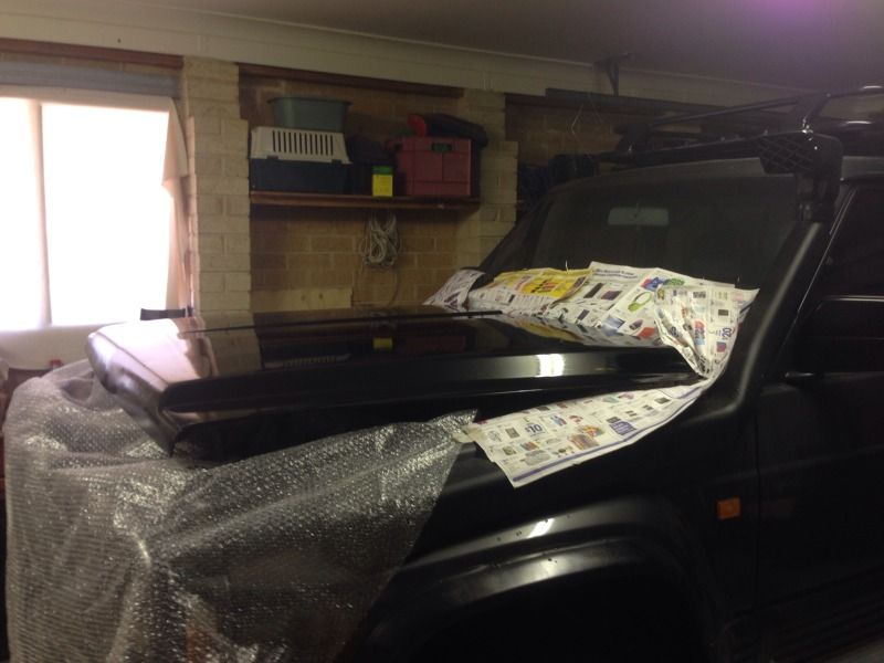

    Things I've learnt today. I used wax and grease remover on the bonnet several times before applying paint, but still got fish eyes appearing. After giving the bonnet a wet sand this morning i used thinners followed by isopropyl alcohol and wiped the bonnet thoroughly and had much better adhesion.
    Use a block when wet sanding. It's easier on the hands and will give a more uniform finish.
    Penetrol does a great job of giving a nice finish, but does make the paint take a lot longer to dry. I tried a 50-50 mix today of just paint and thinners, and the paint does dry quicker, but the finish is not as nice. With the rolling it does create a lot of bubbles like in the video above, and this does make the whole process abit more difficult. Tried the hair dryer method but found this just made the paint dry quicker before the paint had a chance to self level. The penetrol did a good job of self leveling and the bubbles did just pop on their own. Will correct it in the morning with a wet sand and continue with the paint/penetrol/thinners mix.
    Hoping the weather is nicer tomorrow so I can take some outside pics just to see how it's looking in the light. 4 coats at the moment and coverage is starting to look good!

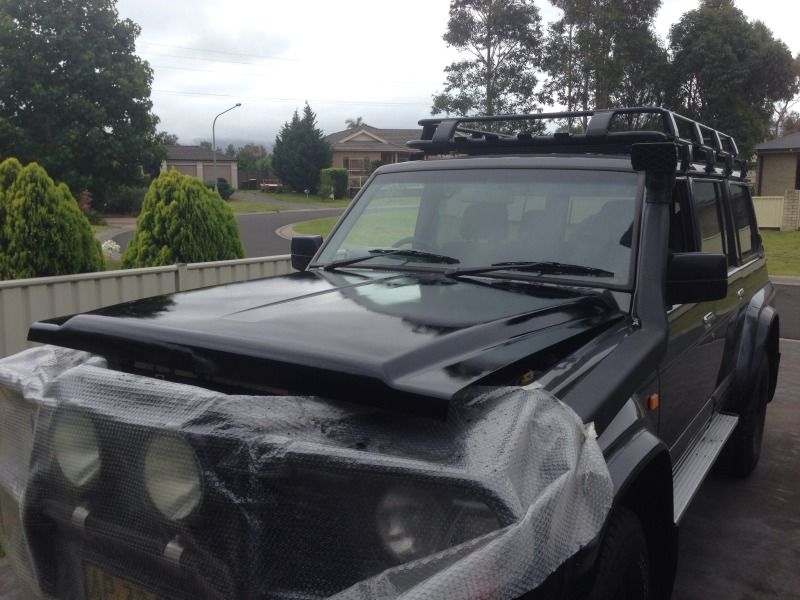

    Coat number 5.
    Still lots of tiny imperfections and orange peel, but appearing to get better with each coat. It's raining today so no outside pics unfortunately.
    Edit: rain has stopped, quick snap shot.
