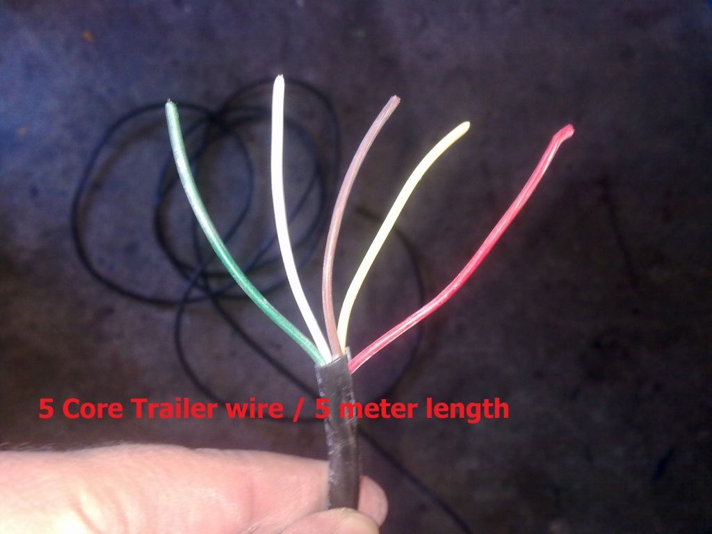

    OK here’s the easy way to wire in your lights
    You will need
    5 meters of 5 core trailer wire
    2 plugs 5 or 6 pin I used computer power plugs from inside the case OME would be better but no one stocked them here
    A soldering iron
    A 10mm socket and ratchet
    Philips head screwdriver
    Flat screwdriver
    A knife or wire strippers.
    You will be wiring them to the trailer plug it’s the easiest way I know of
    NOTE: For reverse lights you will need to use the wire from the reverse light on the left hand side and run the wire across to the driver’s side
    5 Core Trailer wire
    First step is to remove on either side of the 4wd two 10mm bolts that hold in the lights
    After you remove the lights and soldered your plugs on run the wires.
    As you will see there is a grommet on either side as shown
    This isn’t a neat job but it works
    Wire to trailer plug
    Wiring for 7 and 12 pin plugs use the colour coding to help with lights
    Let me know if you need anymore help or would like me to explain a little bit more with any of this
