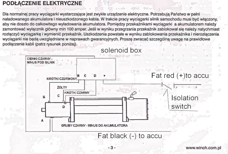

    I put a main starting isolator and put it inline on the main battery positive between battery and winch i did think about doing as suggested above but decided that if their is a problem eg solenoid welds
    on a single direction witch i have seen a couple of times, i can turn it off at the main switch to pervent damage this is also good if the main wire shorts and starts to burn it can be just turned off, i always leave it off unless i need it.

    As shown above instruction suggest switch on main + wire. But still is the question; what kind of switch?
