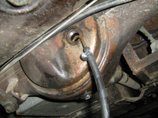

    How to change the oil in your Gbox, Dif etc the easy way.
    (Not a new idea I stole it of the WWW but thought I'd share.)

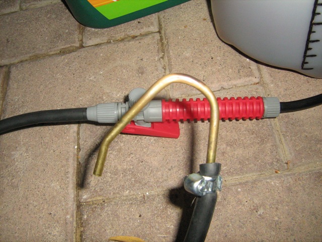

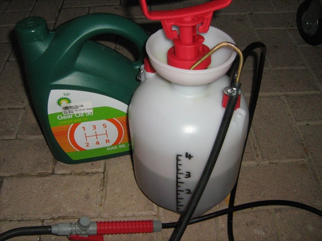

    Trip to the garden center for a weed sprayer.
    (Don't trust the markings, I recalibrated, engraved with a dremel and paint pen. I don't use them for measuring the actual fill but more for a guide.)
    Bit of bent pipe to go in.
    Into the box in question, few pumps to get up to pressure pressure and then let it work.
    No more long funnels or squrting in from the bottle.

    Great idea, but do you have a separate one for each oil or do you clean that one between oils?
    Just the one (at the moment) and I change oil, a few drops of last grade doesn't hurt.
    BUT I am giving serious consideration to a few so I'd have one each grade. If I had a bigger garage I would have more for sure.
