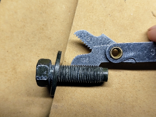

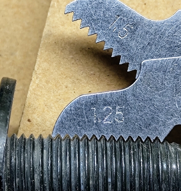

    Quote Originally Posted by timbo2410 View Post
    Nope not M10 1.25 pitch. Mine are a fine thread.
    This is the factory bolt from my rear seats with a 1.25 pitch thread. Does your bolt look like this?
    In my car, one of the four has a thread-repair insert with a 1.5 pitch bolt.
