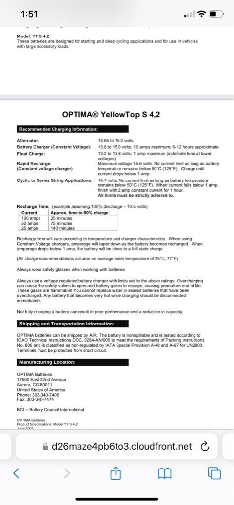

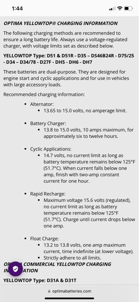

    Thanks mate, it does sound high but looking the Optima’s website says it’s in range but, at highest point that’s for sure.

    Interesting they also mention up to 15.6v for a rapid charge.
