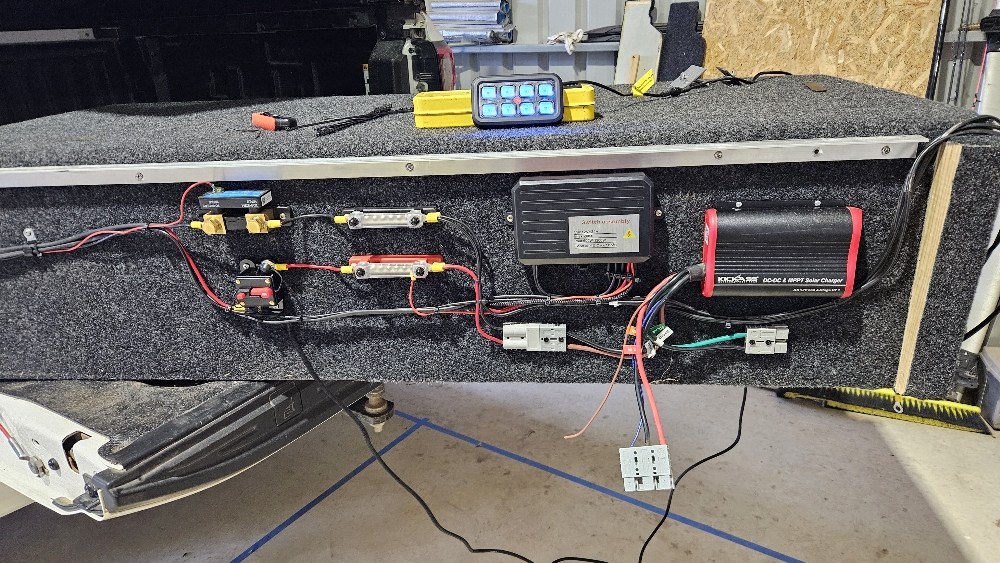

    Nearly done this simple setup. Will be a touring setup and a full time 50ltr weaco fridge.
    110ah agm in the fron of the draws.
    Kickass 25A dcdc charger with solar input.
    Victron shunt.
    EBay 8 switch panel to run it all.
    I've added bus bars for future expansion but probably overkill lol.
    3 cables running to the right are for a remote panel which will house 4 usb ports, 2 cig sockets, solar input anderson plug and a power anderson plug to run a remote power board for in tent charging, or a 240v charger input if needed..
    The 8 gang switch panel is a solid bit of kit.
    The board is resin filled, 60A capacity.
    And Bluetooth app connectivity which works well..

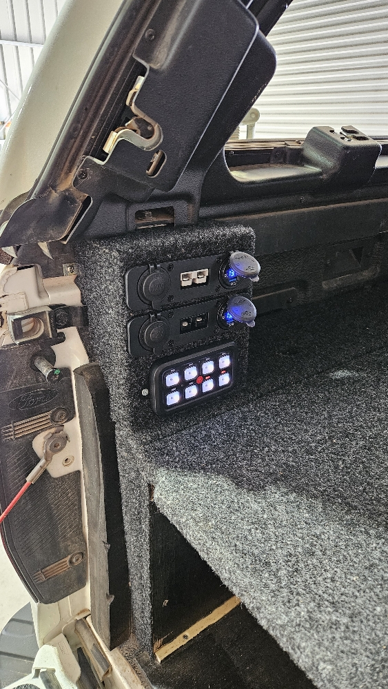

    Switch panel added.
    At this stage button 7 and 8 controll each cig socket / usb panel each.
    Button 1 is the fridge.
    Button 2 is the top anderson.
    Button anderson is solar input to kickass charger..
    The Bluetooth app works a treat!!
    For $200 I'm over the moon with it!!
