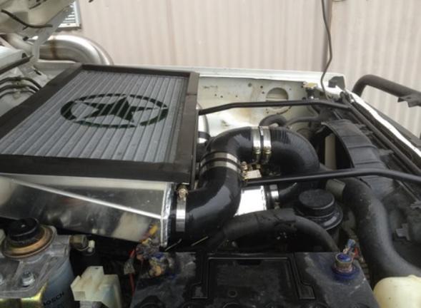

    Genuinely concerned though about firewall issues of flex & impact between the mounting extremities, hopefully I’m just being a worry wart
    Not sure what brand your stainless 4” clamps on your Beaut air intake system are too? I had bought similar looking, anti-seize sticked every single one during installation on my setup and still found over 50% were galled, so deliberately replaced the entire lot for future maintenance ease

    Garrett, I think the load on the very small steel sections will let you down. There isn't much deflection strength in this assy, the welds at the RHS to Angle interface will fatigue very early. The frame is going to be subject to every vertical motion and I will say its a great concept but ultimately wont last the distance. Anyway give it a whirl I guess but I hope it does not come adrift in some awkward location and do further damage.
