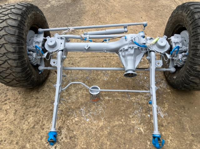

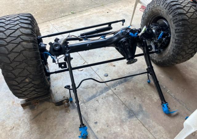

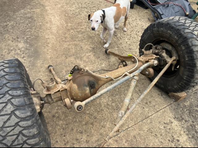

    Commenced degreasing and a hot pressure scrub a dub dubbing:
    Surface rust conversion completed and primer applied thereafter:
    First coat of black atop:
    A few more coats and the front end of our 3.9 ratio tourer for starters is ready for Australian beach shenanigans

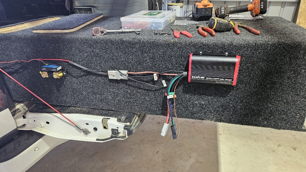

    Well now that I have the draws majority done I'm starting to work out the 12v stuff....
    No plan. Just doing it the Westbrook way..
    So I have run 5mm cable from main better to rear tripple anderson plug, which I feel may be a bit underdone but I'll keep an eye on it..
    Kickass dcdc25A charger with solar input.
    I landed on this product as it has a good wrap and price is good.
    I also had the victron isolated charger unit in the bascket but it's not compatible with alternator and solar, so would have to run 2 separate units which probably would have been ok but looking to keep this simple..
    I did however drop some coin on the victron shunt..
    I love the app and the way it tracks.
    So for now untill I sort the switches, this is how it will be. I can easily slide the draws in about out still with it all mounted which is key..

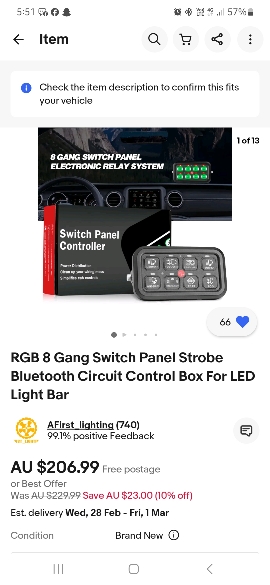

    For the switches I feel like going fancy with this one... anyone used something like this??
    I like that ist the switch bank, and fuse bank all working together. A touch nicer than rocker switches...
