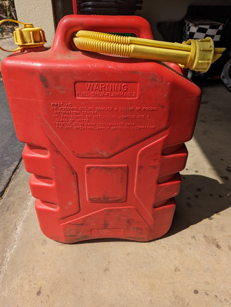

    What's people's experience on the topic.
    I should have a rear bar with dual jerry can holders before the Simpson trip.
    Question is I've had this fuel safe one for several years now and it leaks. Should I replace the o ring or buy 2 new ones. Stick with the same brand or something different, plastic or metal?

    I would change the o'ring. The cans are well supported in a jerry can holder, so as long as the unit is not split it should be fine. Of course if you are concerned, retire it for a more non mobile life like a shed supply and buy two new ones. I have metal cans and will simply use them inside metal can holders. I have no preference for metal or plastic as long as they are manufactured to a recognised standard I guess.

    Apologies Philstar, I’m going to have to honestly suggest turfing it
    My experience with that exact same brand piece of shit can is the threads on the cap/can are a short use life
    EDIT: From nuffy experience, them exact placcy cans themselves were decent, the caps were pissweak though and expanded upon normal tightening/ambient/radiant heat.
    Be weary of the corrugated funnel too, they split on the tips and pour down your thighs whilst smoking

    FWIW: Modern- Metal cans in this day and age DO need to be thoroughly flakey/gritty checked by oneself prior to relying on also
    Military Spec is an Absolute past quality dream

    Unsure where military spec came into the conversation, i am talking about Australian Standards. I agree the plastic cans are a challenge as they expand more than the metal units and ultimately you rely on a plastic cap and 5 cent oring for the seal - have had a few blow up like a stuck pig and pass/weep out the cap agree. The lid on the metal cans are more robust for sure, so buying new plastic may be the weaker option, but then again there are a lot of these units out there - comes down to choice I guess. If the plastic cans are made to a recognised 'standard' as applicable, maybe thats the brand to look at if going either plastic or metal.

    Vertically carried/carted and or horizontally standards passed/fail
    In regards old school “cans” yours are true, modern wannabes are known for paint flakes and the like

    Most leaks from the cap area are caused by rough finish on the container spout (the surface where the O ring seats) so that the seal does not meet a good flat even surface. I have fixed a couple simply by dressing this surface. And O ring may also be chewed out a bit if it is real rough.
