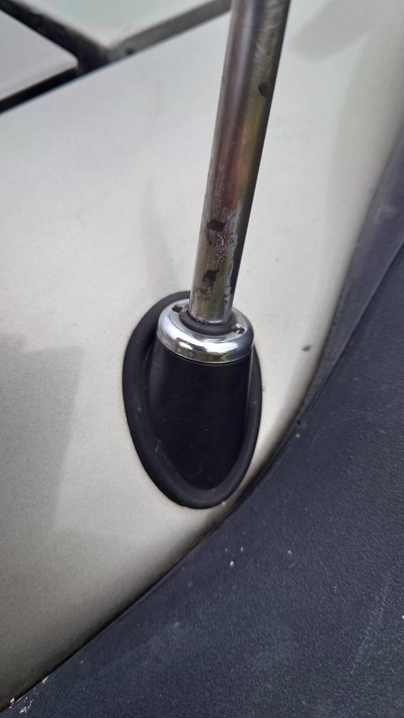

    G'day, how does my aerial unscrew? I watched a vid and the aerial had a hex but to undo. Mine has these holes, not sure how hard to tap

    Yeah mate get a couple of prongs in those holes and unscrew. Circlip pliers if you have them will do the trick.

    Why do you want to remove it? You need to remove the inner guard to drop the aerial and motor out, and I'm pretty sure theres two bolts, or nuts, that you access from the LHS of the foot well. I replaced the antenna cord in mine a long time ago and had to do this. Then I was sick of it going up and down everytime I turned the ignition on so I just left it down and disconnected it and put a whip antenna on the bull bar.
    It uses a tool like this (we call it "vampire" over here) but it is pretty easy to improvise.

    Well in the GU im 99% there is two bolts via the LHS kick panel, then the entire motor and aerial drop out from behind the inner guard. I just left the aerial there and in the down position and just disconnected it.

    Hi mudski
    The cable or whatever connects the aerial to the motor must have broken because i can hear the motor running but the aerial does not move up or down but the radio still works, you said you disconnected yours power supply which is what i want to do but where is the connection i looked behind the kick panel and there is lots of plumbing under there is it one of those?

    Hi Mojo.
    You can just isolate the aerial power signal on the head unit harness. Pull your head unit out and cut the wire and your are done.
