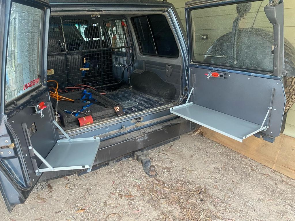

    The old girl is getting a makeover over the next few months.
    Just installed some new tables for the barn doors.
    There’s a channel under the tables where I’ll make a slide out extending chopping board over Xmas time which will be a win.

    Looks pretty cool. Can you take one of the latching mechanism at the top?

    Looks great Andy.

    Nice mate.
    Did you make them yourself?
    Will do tonight for ya.
