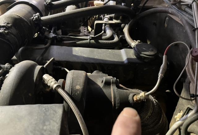

    FWIW: Also scored 425C on the EGT’s deliberately trying my hardest to pop 5th GQ gear properly sooting up a 3-5 minute highway incline
    Where is your thermo mounted? I'll clock 412 going up a lazy hill.
    Probe is on manifold (under heat shield) before collector, between 3 & 4 cyl...

    Apologies, missed the question with only one eye open…..It’s here on top of the top mount dumpy pipe @mihit Mate
