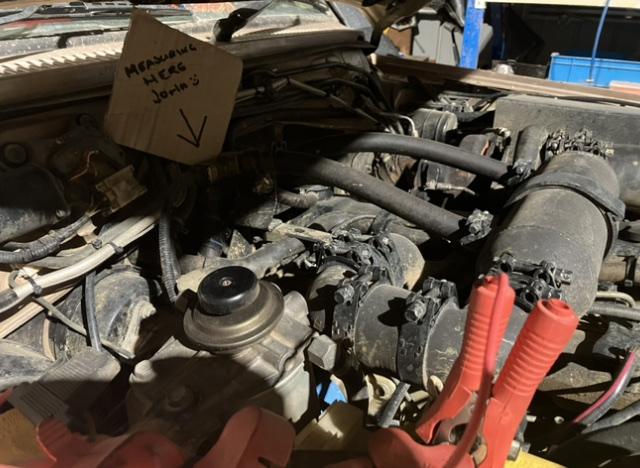

    Not as yet sorry John, no data there unfortunately, had to cut a few items off the full rebuild only 1,500km running in still ago. Are measuring water temp coming out of the exchanger at the re-entry point of the intercooler barrel (turbo side). Haven’t been able to get it above say 55C and the highest possible EGT’s (Exhaust Gas Temperatures) have been about 400C although haven’t towed a trailer as yet. Being a ute I have the exchanger on the open headboard cooling via roof air passing over and haven’t really used the electric fan for it yet as it’s winter and I need to reverse its polarity from rushed installation for a Tassie trip

    Apologies Dean & John Mates Washing up after a weekend away remembered Nuffy posting rushed data/statistics posted above were incorrect
    ‘MAX’ W2A water/H2O so far achieved heading ‘back out’ for headboard treatment this mountain weekend has been 47C highway exchanger fanless.
    The “55C” flogging original now highway test was in fact water/out after being cooked/baked by the Intercooler in say sub 15C ambients highway home
