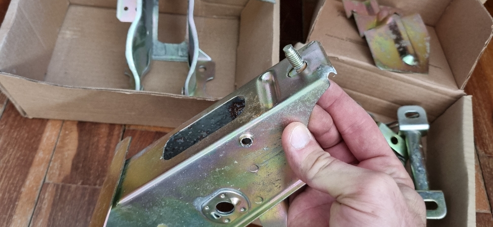

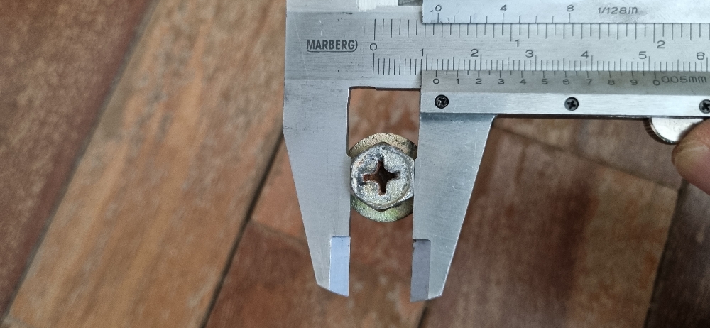

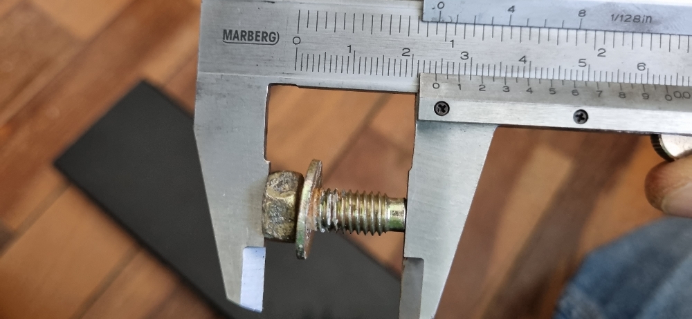

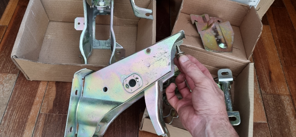

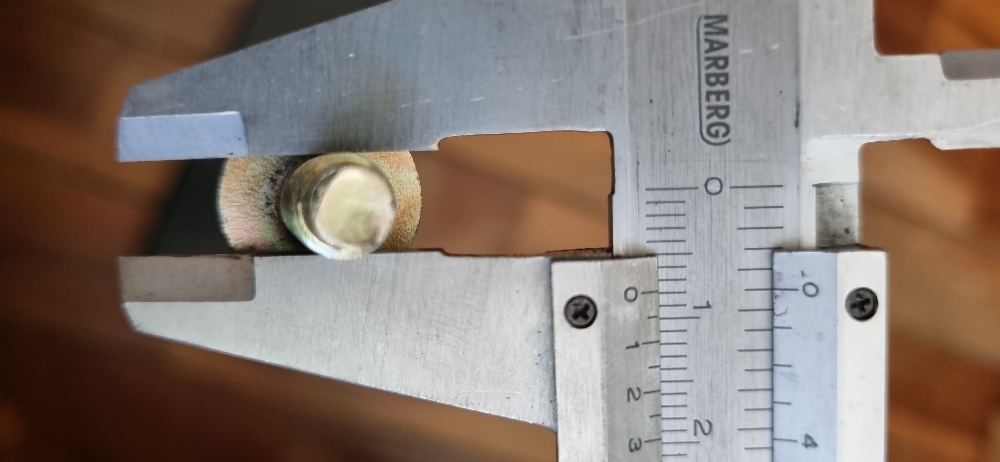

    Ok, so its one that goes upward.
    The one I have here is a 12 mm with the following lenth and thread:
    Absolute superstar, thank you so much dude!
    Yeh M8 x 20ish if you include the non threaded part (occasionally I get it right &#128517
