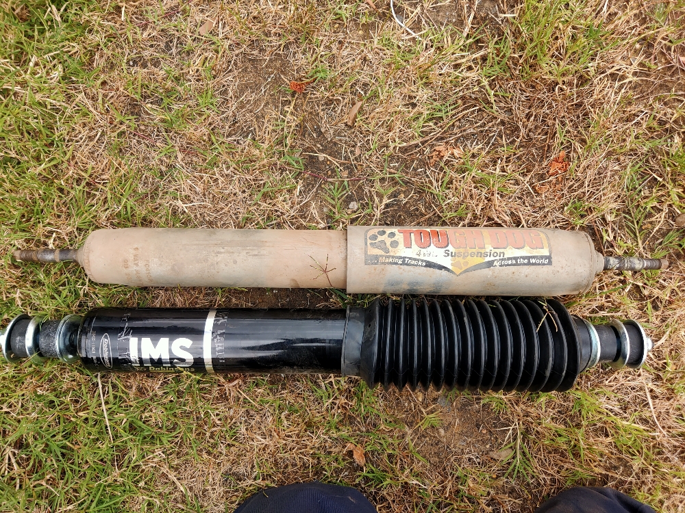

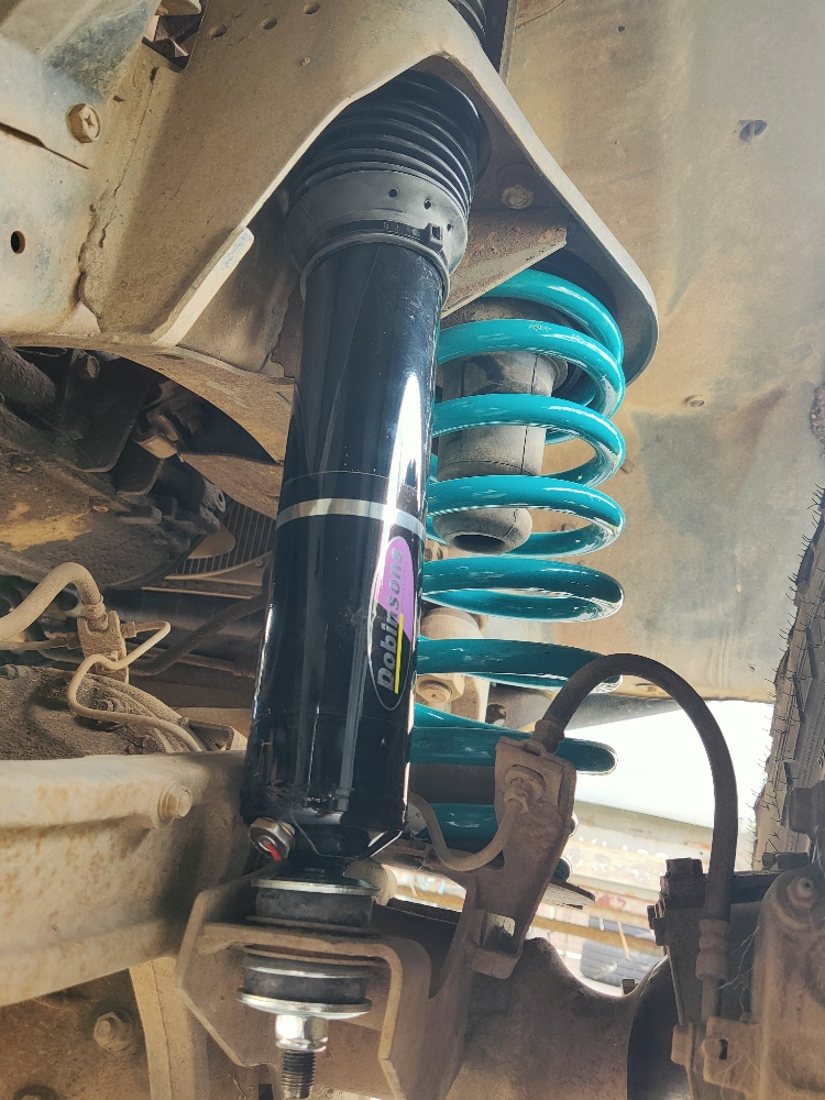

    We'll today didn't go as planned. Was meant to be a straight in and out with the new springs and fit up the new sway bar links.
    Swapped out the old springs, and discovered that 3 out of 4 shocks have no return in them. I checked them all when I started having the lean issue and all were fine. Anyway the old suspension set up is 7 years old and around 150,000 km , so probably over due, shocks are 41mm tough dog foam cell,

  6. #634
    483 Post(s)
    Bang for buck proclaiming again John Mate, Dobinsons now have 3 levels/range of coin shock
    Original, twin tubes which have always (last decade) served me cost wise happily very well & their remote reservoir full tilt more expensive performance variants unfortunately out of reach. Worth checking out their middle of the range/performance IMS shocks:

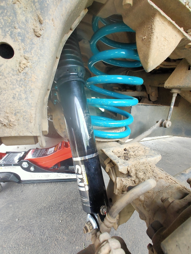

    Well I was hoping on possibly being the first GU on club reg, still might happen only taking a bit longer than expected..
    Being buying up the last few weeks and today was patrol day.

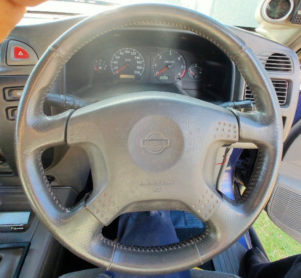

    New Springs and shocks (took @MB advice) and rear brake pads. Steering wheel and radio surround was a good score at the local wreckers.
    Old tough dog foam cell did around 150,000 km in 7-8 years and now have no return. Replacing the 25 year steering with one with no rips and I reckon the best score was the radio surround with only 2 little screw holes and nothing else, never seen one without and antenna switch.

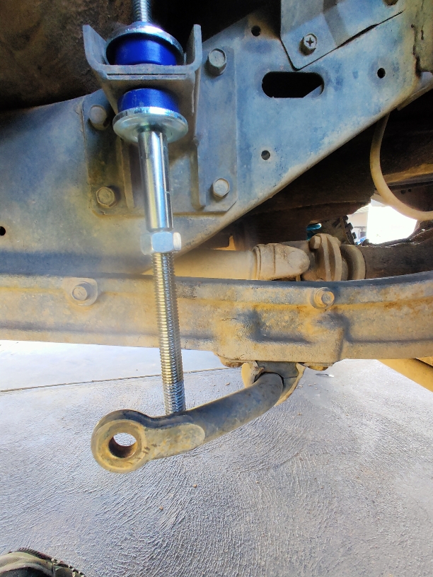

    Question on the sway bar links..
    You can see that once I cut the thread to size it won't line up straight to the bar, if I force it, it will have a lot of pressure against it. What am I missing here.
    Can't wait to get this thing back on the road..
  12. #638
    5,308
    5,052
    Thanked 5,461 Times in 3,011 Posts
    The rod will pivot in the rubbers, my front and rear sway bars were the same, not a lot of accuracy intended.
    Thanks for clearing that up..
