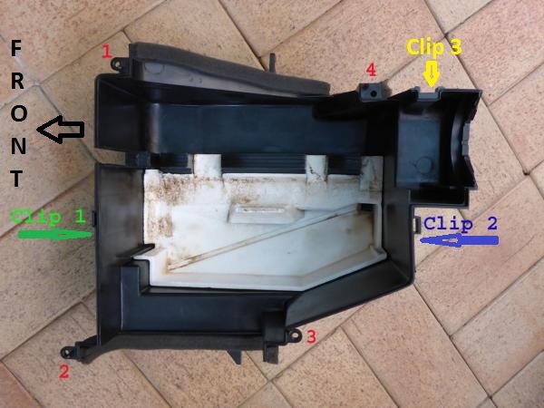

    do you know if it is possible to drop the lower part of the evaporator box?

    Well, I still want to drop the box lower part if possible... I have vacuumed the hell out of it from the fan opening, but washing would be a better take at it.

    This is from the Patrol4x4 forum detailing all screws and clips to remove to detach the bottom half.
    Could not go any past the screw #3. Screw #4 and clips 2 and 3 are impossible to get. At some moment I even thought I could get them out but for sure it would be impossible to get them back in.
    So, with 1, 2 and 3 out, I jammed the vacuum cleaner hose on the right chamber (the one that gets all the crud straight from the fan) and used compressed air on the opposite side of the evaporator. Not 100% clean in terms of powder but there is definitely nothing blocking the fins now. I have complemented the job with A/C cleaning / disinfecting spray. I am happy with it for now, until my cabin filters arrive.
