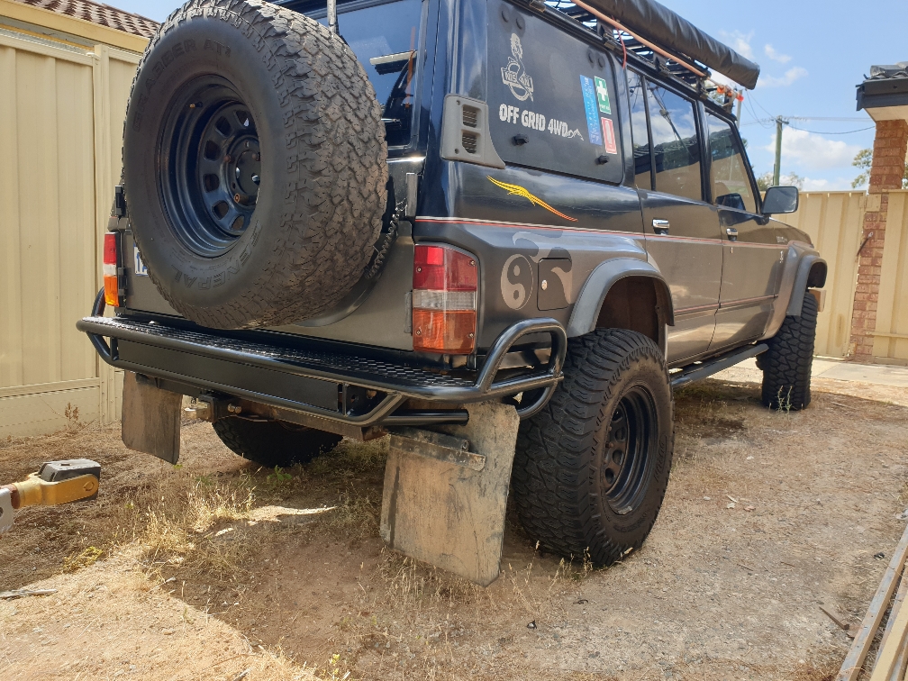

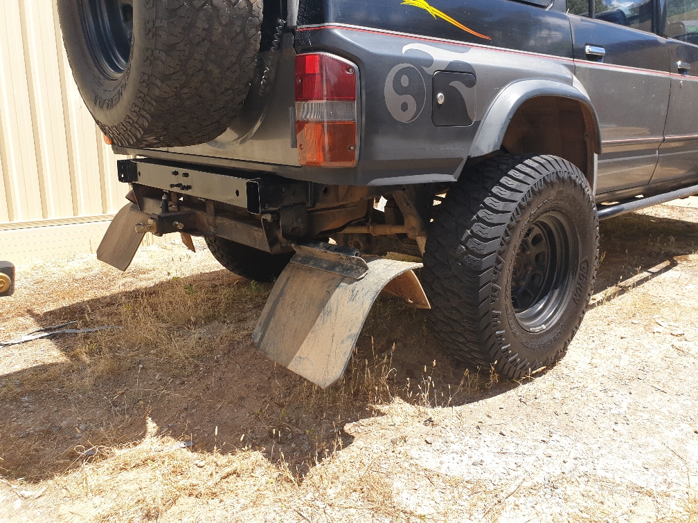

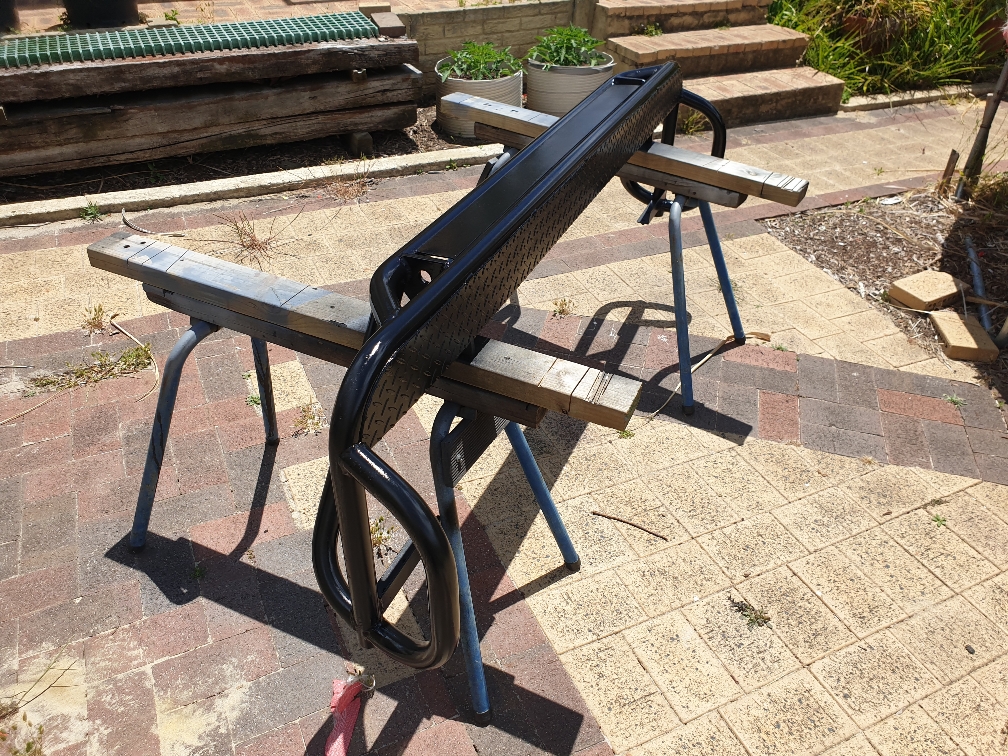

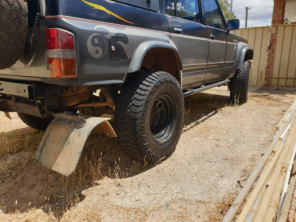

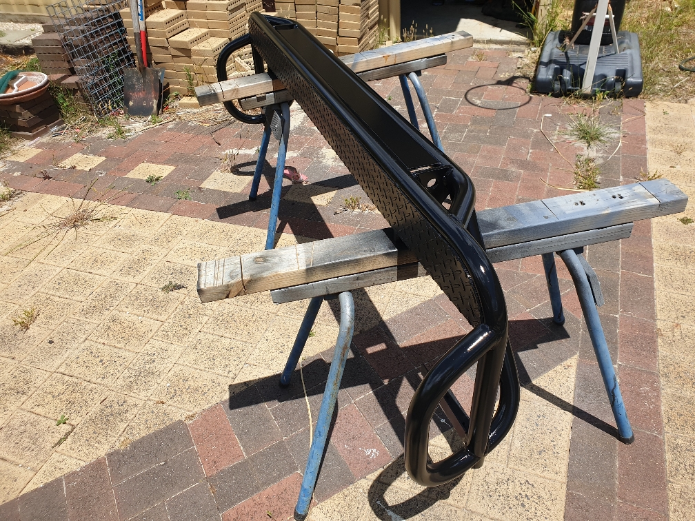

    Well its been a while but I decided to pull the rear bar of and give it a spruce up...bit of a rub down, wash and then I used etch primer on the powder coating...topped it with black rust kill gloss...came up alright...just waiting for it to go hard...
    Also dropped the trol down on some 33s on steel 16x8 neg 22 D hole rims. Looks a bit different but the NA will enjoy the extra torque when towing.
    Poor thing hasn't seen the road since March due to me being ill...looking forward to getting it out again soon. Its almost Xmas and we need a break from suburban crawl.

    All back on the bus...came up great...ran some more coats on the quarter chop as well...
