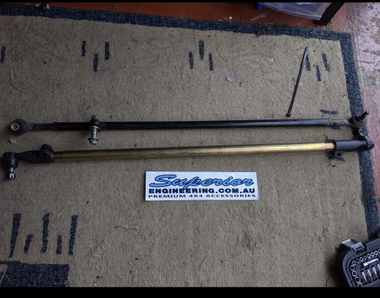

    No Way i would fit an OEM Drag link Ever mate.
    A Superior or Roadsafe brand Chromoly in 4140 with female tie rod ends for the win. It is the most exposed item on the car for impact and the factory is piss-weak.

    As Mudrunner said. Get something decent while you're at it. Anything compared to OEM is stronger. I opted for the superior link. Bees knees.

    Yes indeed. You will get the grease boot for a tie rod end at any Auto shop (Repco, supercheap, autopro) will all sell the. For $10 or so. Nice to have a spare.
    For my money though the first link I changed on both the GQ and the GU was the Drag Link and the Tie Rod as they are both Very exposed and the Drag link is the first thing to hit something. If the tiered end is knackered then don't replace the end, junk the whole thing.
    If he is flat out not using rhe car offroad then go the boot for sure. If he has a head shake replace rhe rod end. If he wants to do some tougher tracks junk it and go chromoly 100%.
