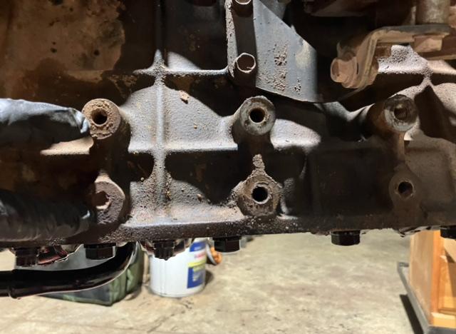

    Only out of honest interest whilst stripping down the old TD42 Blacktop. Does anybody know what the additional 2 x engine mount castings were for on these engines?
    Thinking maybe another vehicle setup like Nissan-Civilian bus or Overseas power plant applications possibly?

    Probably for that or the TB engine mounting points as the block casting is the same I believe.

    Reading that just got me excited starring hard at a TB Maverick outside the shed.
    Would it in theory be possible to TB block rebuild with a TD head and other internals required?

    TD blocks are a dry liner block. The old ones get pushed out and the new ones get pressed in and then usually honed to finish. Rebuilding TD42's is a fine art. You need to find a good builder who has good experience in rebuilding them. Little things like not using liquid nitrogen to install the new liners. Making sure the parent bores are in good condition and if machined are machined correctly. Liner protrusion is also a big one. Little things on the procedure help here. For example if the block needs decking then it needs to be done prior to liner installation. Then if the liner protusion needs to be reduced then this will be done once they are pressed home.

    The blocks were used in a multitude of applications. Anywhere from our humble patrol to a bus as you mention also forklifts and marine applications.
