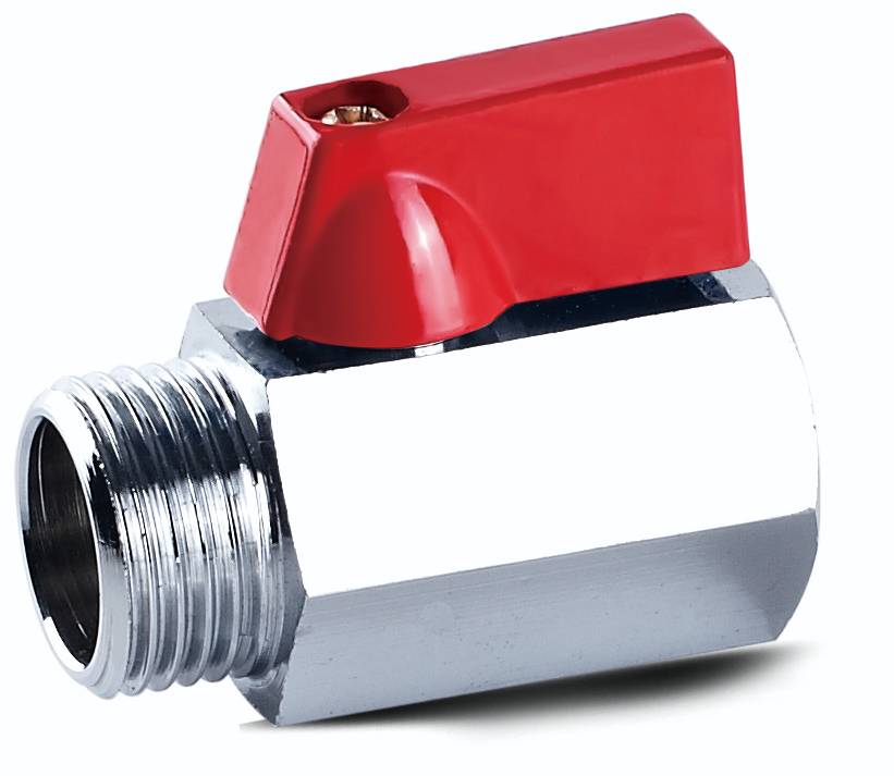

    Hopefully I am picturing your setup correctly, but it sounds like this kind of mini ball valve would work for what you need?
    It may need some adaptor for the thread, but it's pretty inexpensive.
    https://www.valvesonline.com.au/mini...valve-m-f-ends

    Thanks Cremulator,
    it's not a ball valve I need - they are manual. I'm after an automatic system. One that will let air in to prevent vacuum and let air out but not water.
