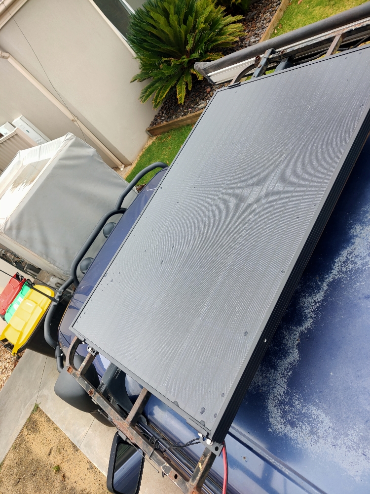

    Forgot to mention that this panel pools water on top when stationary due to the raised folded edges. You can see it on top of my panel here.
    Which is why I attempted to drill the corners as drainage holes and in turn shattered the first panel I had.
    Sent using Pixel 6

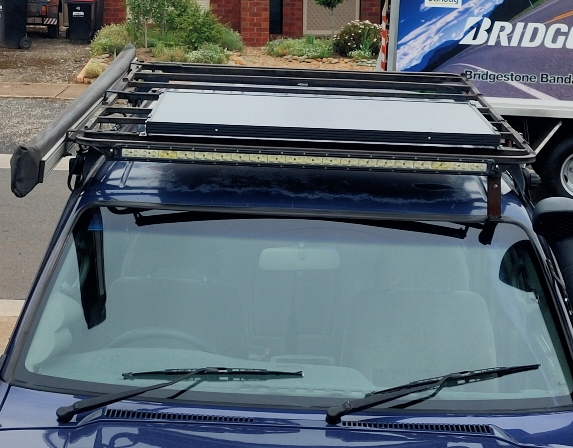

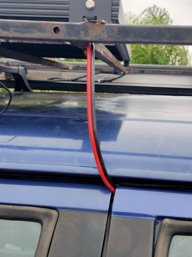

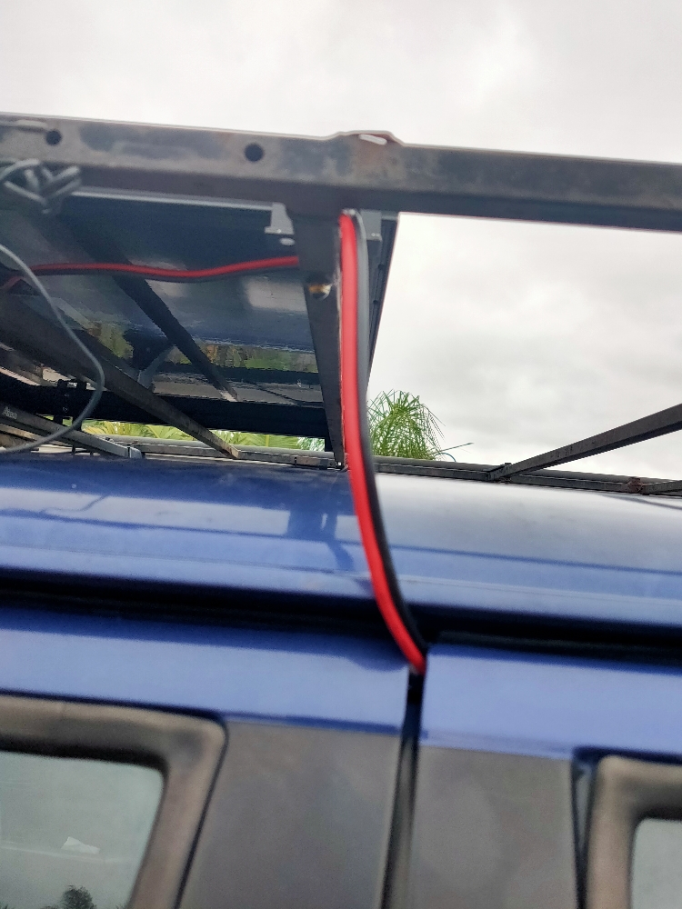

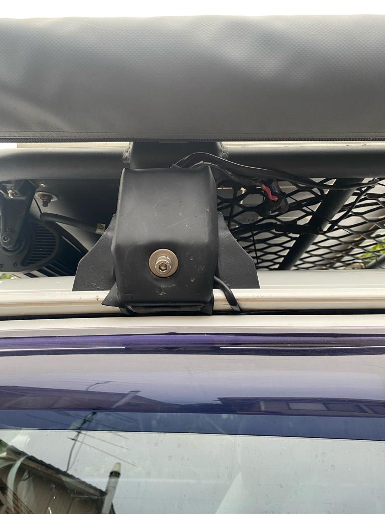

    Job done.
    Run out of some tidy up bits , but there's a bit that that wanna clean up.
    Only thing I'm not too happy is how the cable enters the door. Was thinking black electrical tape along that section (one of the things that I run out of).
    Should get the new redarc isolator on Monday and that's a swap out.
    Thanks for your input gents..

    @jaysee, I would route the cable into the roof gutter on the passenger side and sneak it across and to the rear of the snorkle, then down the back of the snorkle and into the gap between guard and pass door. then into engine bay or chassis rail or in thru the inside of the guard into pass footwell, assuming there is a similar route to the GQ. Cable remains very protected and you cab disguise the run in the gutter with corrugated sheath

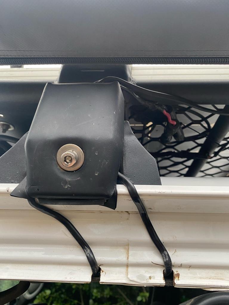

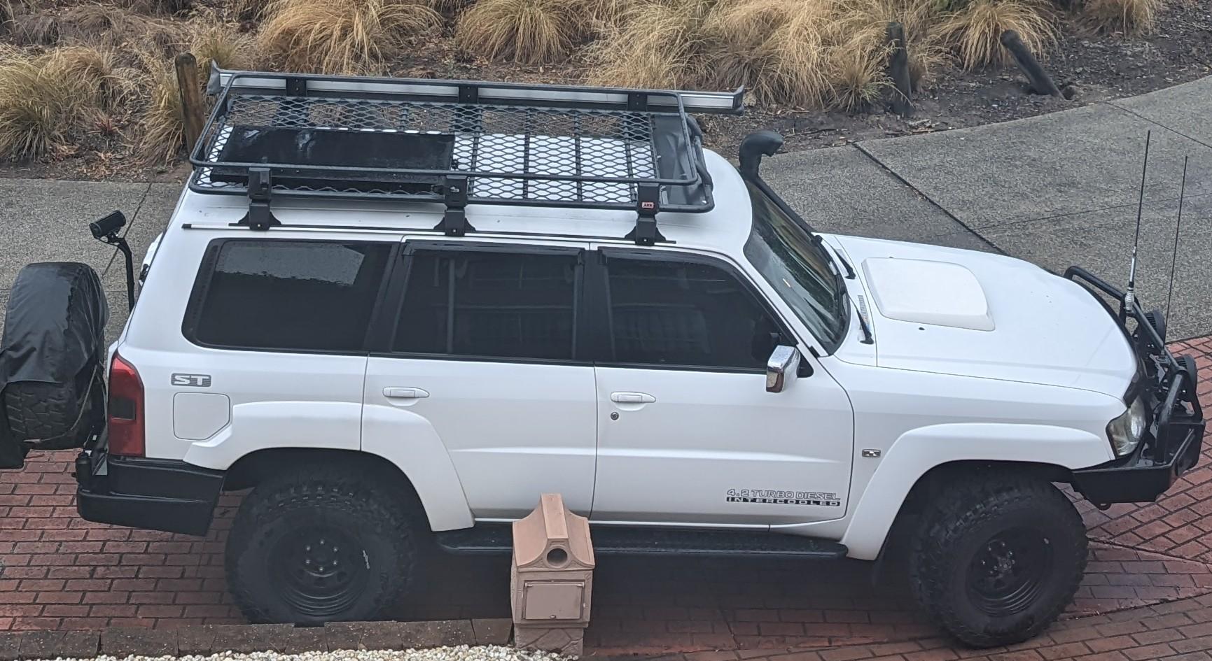

    Jay see 1997 GU build up
    John this is how my panel and light bar are routed.using 4mm twin core…
    I thought of that for about 1/2 second and that's too much work, well for me anyway.
    This I considered, as I can run the cable behind one of the legs of the rack. Only thing is I didn't have enough cable.
    Will probably tape/conduit it for now and look at it again after.
