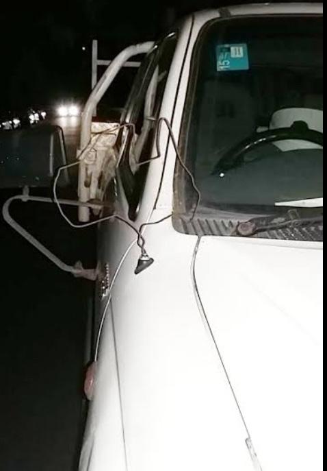

    Probably no help JMan but I gave up on electrical fang dangling rubbish years ago, clothes coat hangers down under work the best for both AM talkback & FModulated boogie time

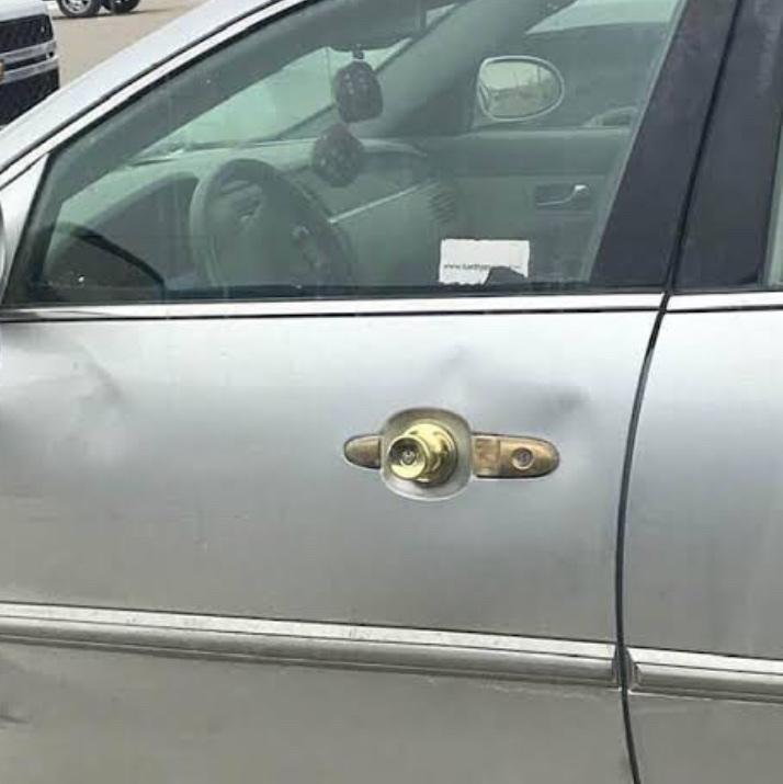

    Thanks MB. Nice mod's. But you're right ,not much help. I like the door handle. Reminds me of Mr. Bean and the lock on his Mini. Lucky i'm an A.M. talkback and F.M modulated sort of guy.
