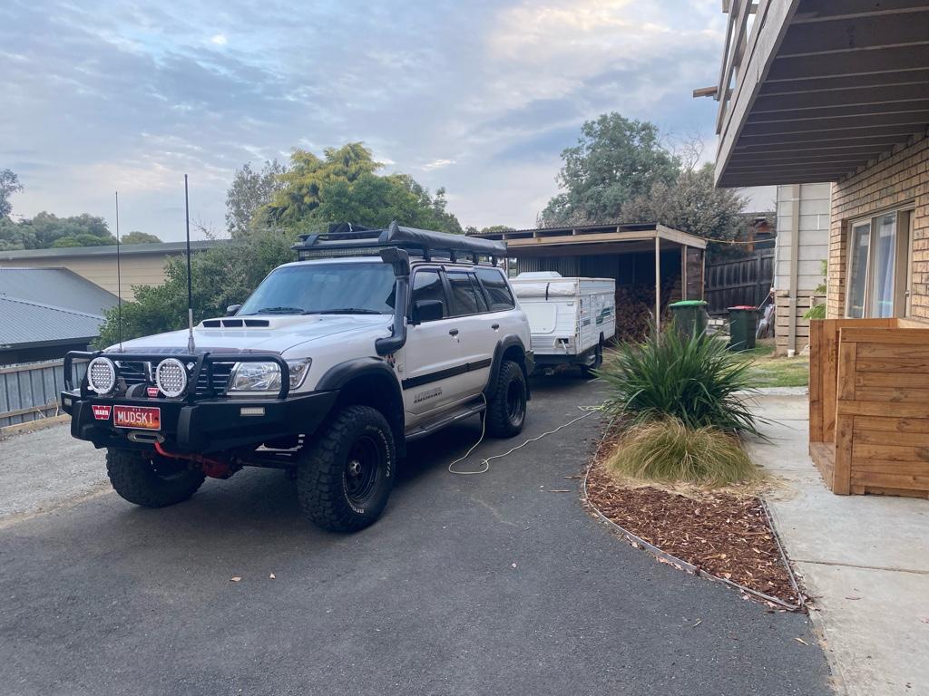

    Lecky gremlin sorted, finally got the Redarc ambient temp sensors in and working.
    Patrol is fueled up and packed. Ready to launch at 4am tomorrow for a much awaited trip to Merimbula. The last two years were thwarted by fires and then border lockouts.
    Can’t bloody wait!
