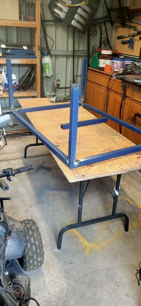

    I got some stock from work to build a fire wood box on castors so I can store it under the smoker which is next to the oven and I and wheel it out to the fire pit when needed. It will also make it easier to load it when empty.

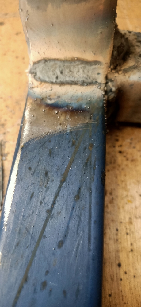

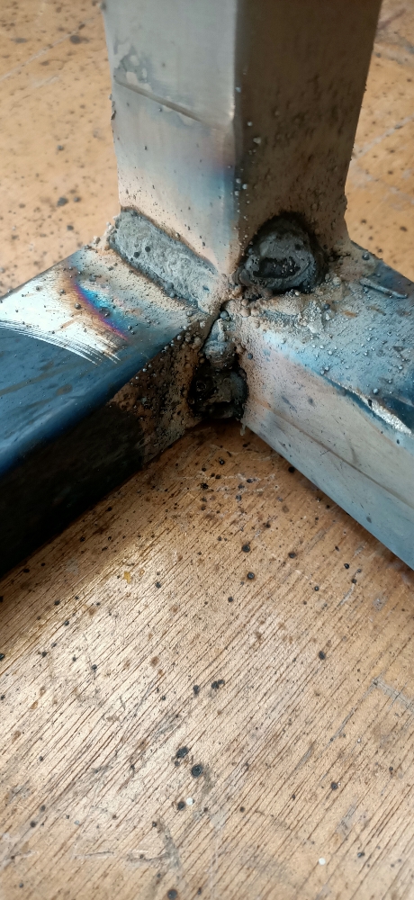

    Happy that I started and got a couple good welds down. Pissed that the others look like a dog's breakfast. So out canes the grinder to clean then up.
    Are you using gasless wire in a mig or stick welding?
    Gasless

    Gasless
    A lot of gasless needs the polarity to be reversed. So the electrode into the negative and the earth clamp into the positive. This will help to settle it down and make it run smoother for you. But it is always best to check the manufacturers instructions as the electrode polarity will be in them.
    Yeah I know. It's set up for gasless. I can reverse it and run a gas bottle, but if I can weld as good as some of what did today consistently I'll be happy
    Buy a gas bottle mate, heaps better. No comparison...
    Guy at work has the same welder and has no issues using it as a gasless. I'll try a new tip and see how it goes. Besides the last roll of wire I brought was a 15kg roll of gasless wire, if it's still giving me issues I'll change to gas when I need more wire..

    Theres no issues with using it gasless agreed. but using with gas is easier and a much better weld.
