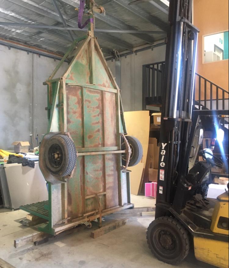

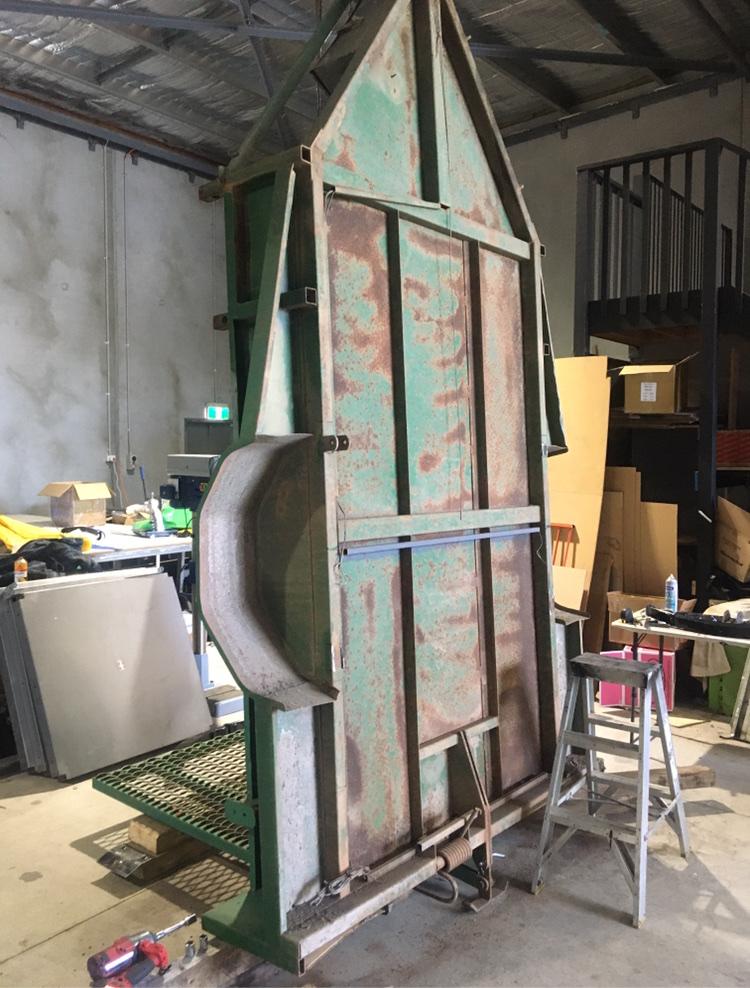

    In addition to all the Excellent Advice kindly posted above we do like to fully inspect our trailers undies whenever possible
    Currently upgrading springs/guards/axle to a heavier 6 stud share pattern with its little old tug and have fortunately uncovered an extra days worth of chassis crack starting attention needed too thankfully before a hopeful NT work departure

    Nice work mate, What is that trailer used for? i note the ramp on teh back but also the lack of any real chassis. There aint much trailer there. My homemade Tandem (made by another guy) is very much like that and disappointingly light under the tray.
    It's his kanga trailer mate, probably loaded with an 800kg machine? Maybe slightly less?

    Yes, it’s the original Kanga brand trailer purchased 25 years ago to help carry our then new G520 little hole digging machine to the market ….still going strong to this day and is coming to NT off the back of the Acco and back on its trailer
    3.0T silly 65mm round elecy drum braked new 6 stud axle going under with 2.5T 10 pack bushed leafies larger guards for up to 33” if needed and extra steel undies galore for up to and under 2,000kg total gear strategically stacked on/around/under old faithful Kanga
    EDIT: Not total “gear” atop, meant total ATM (GVM) as is plated at 1,950kg ATM
