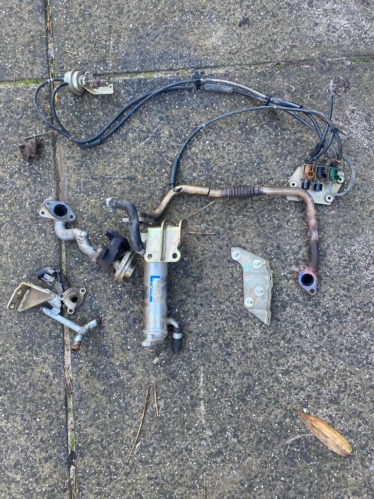

    Good outcome mate. When I got my CC intercooler I got one of these kits mate. While you have that area pulled-apart..
    https://hpdiesel.com.au/nissan-patro...xoCf74QAvD_BwE
    This gets rid of that EGR cooler above the oil filters. Takes some load off the cooling system.
    Cheers @Hodge that’s exactly what I was installing.
    Only thing with the HPD kit is that it only comes with one blanking plate. Iv got it all removed now and have blocked it on the exhaust end (the hardest part), now just waiting on another blanking plate for the inlet manifold.
    Did you upgrade your turbo after you put in the new cooler?
    Pic of it all removed
