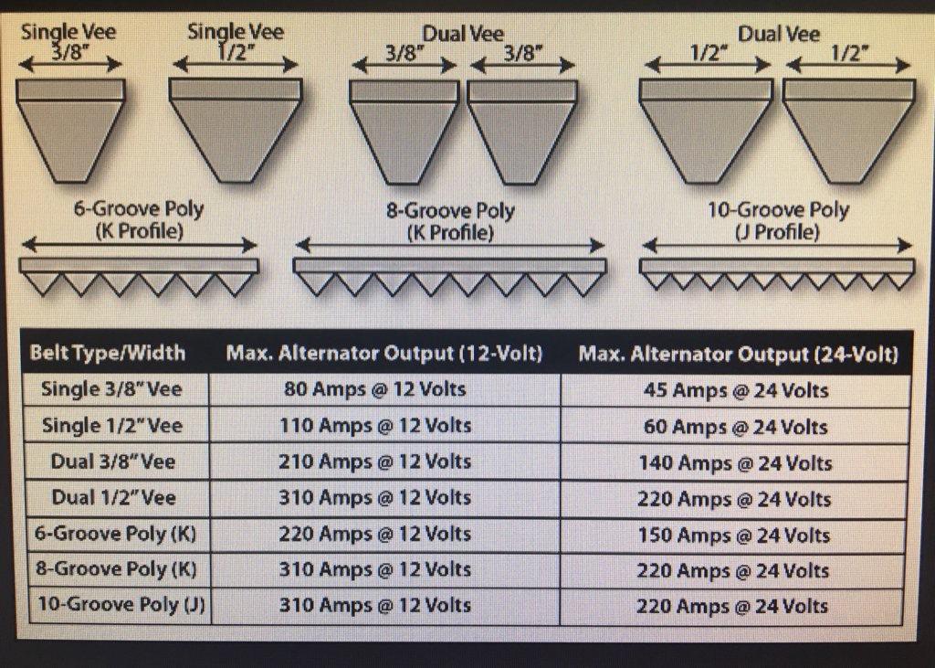

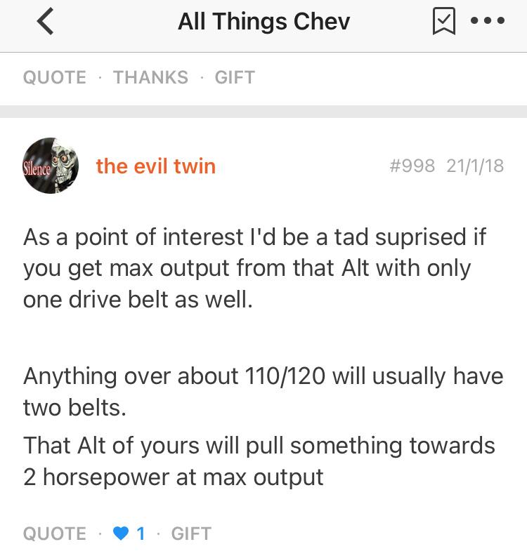

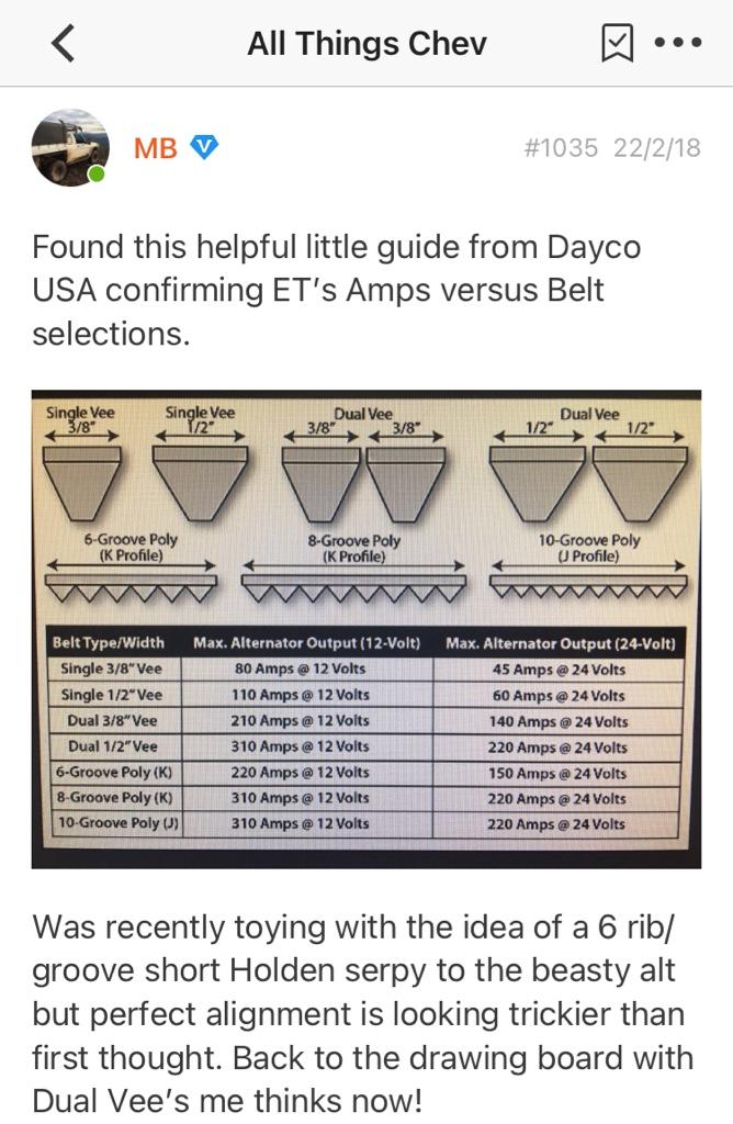

    FWIW: 120A tops 130A I believe is the MAX a single 13A belt can safely drive too.
    I managed to score a pimped up GQTD42 180A jobbie years ago for my 6.5 GU.
    Initially it cooked the diodes under stress until @PeeBee kindly ordered me in an external rectifier pack from the States. That fixed the cooking issue no problem but unfortunately the next problem became belt slippage under heavy loads duress.
    The Evil Twin Legend on here kindly posted up a graph somewhere years ago helping us which listed the required belt/s V & Serpentine variants required for higher output alternators

    From the Legend Himself, We know and Love him as ‘ET’

    I sell some seriously heavy duty 13A belts at work Marko. The Gates Fleetrunner range are top notch. Phil and Eric can vouch for them.
    It’s a slippage issue I’ve found Mr Mark Mate!
    Fleetrunner are the strength bomb for sure but surface area versus loading I believe now is the greater issue?
