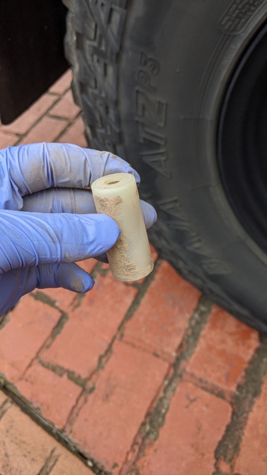

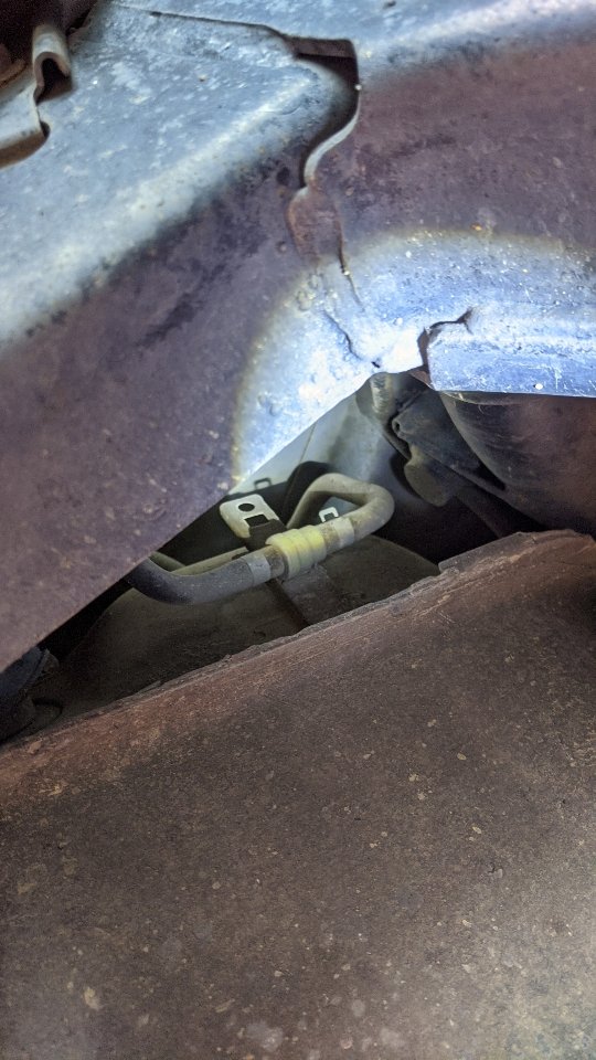

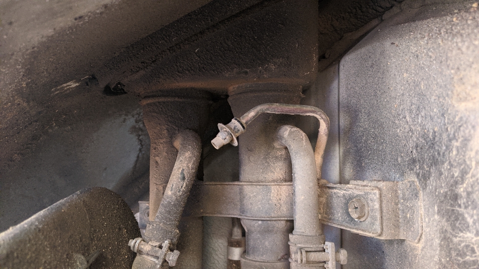

    Quote Originally Posted by sussgq View Post
    hey mate! nah that’s the little breather ‘cup’, it’s supposed to create a pocket of air to avoid water entering the tank if it was to be submerged, but it isn’t very affective. the one way valve is a very small black tank just off the side of the fuel tank behind the flap that covers the filler neck! best bet is to extend the breather up high and bin the one way valve
    Yep gotya cheers for that ! I think I traced it out ...
    I come across this...
