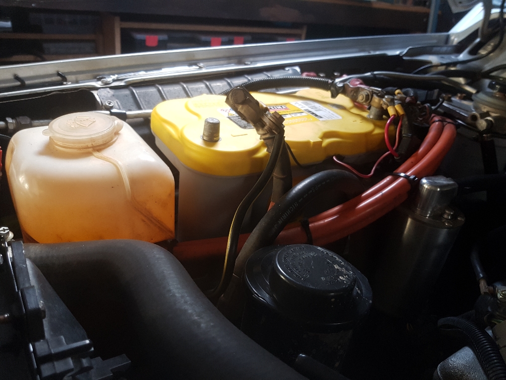

    Optima D27’s Yellow pairs (800 CCA - 66 AH) have never let me down under bonnet with hotter running GU TD42’s & a 6.5 Chev stinker for shorter stays and winching.
    Extremely fast charge recovery and half the amount of internal connections to the spiral 6 pot design versus standard 12 plate battery designs.
    I think some Odyssey batteries might have epoxy filled tops or bottoms to vibration protect the standard plate connections which would be good too I imagine.
    Just managed to barely squeeze an Optima D31 Yellow (900 CCA - 75 AH) into the GQ ute which is getting connected to a DC/DC thingy and off to a Kickass (AGM 170 AH) on the tray headboard with solar above, fingers crossed
    Must say the extra 100 CCA of the D31 gets the starter motor cranking off its head, looking forward to winch tests on build completion soon hopefully
