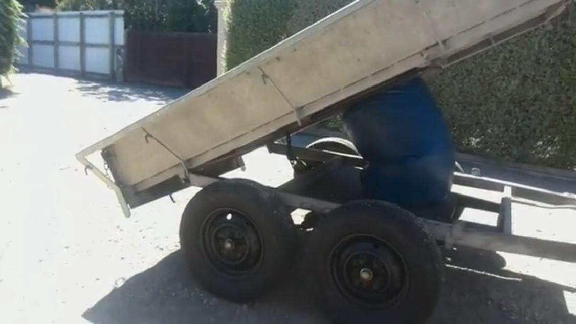

    Just another wacky idea I once viewed on a Youtubey firewood cutting/splitting and carting contraption binge.
    A bloke ingeniously strong hinged his strengthened up trailer tub at the rear and designed in two chunky flat plates underneath towards the front with approximately a 100mm gap between the chassis plate and the tub plate.
    Shoved his pumpkin bag exhaust jack in the gap upon arrival back at his house and saved himself a squillion on hydraulic rams/pumps/lines for a pretty tough bush tipper trailer
