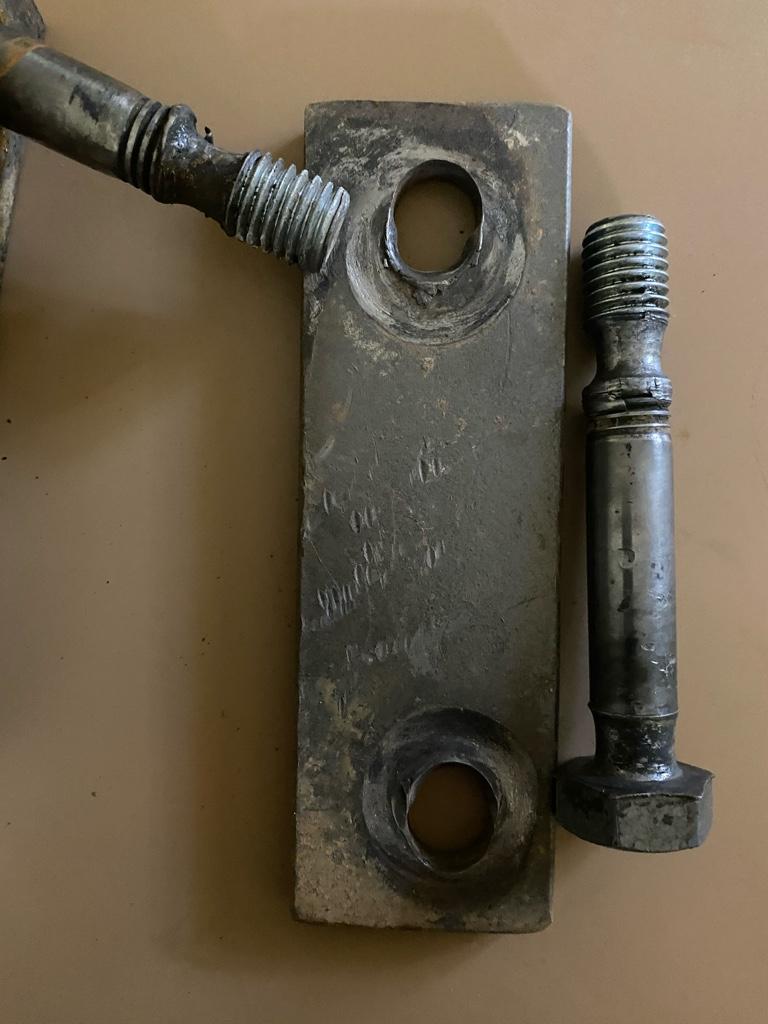

    I just went through a bit of an upgrade myself and used Huntsman mob as you can’t beat their pricing.
    Their warehouse packing guys tho need a good kick up the arse...lol
    Ordered 2x 6 leaf springs and got 7 leaf...all good easy fix. Also ordered 4 x U bolts and washers and nuts and got 12 of each and a mystery bag of different bolts and nuts...beauty
    Anyway, this was the state of of my good bolts and brackets. Both springs lost centre bolt and kept moving around...oops
