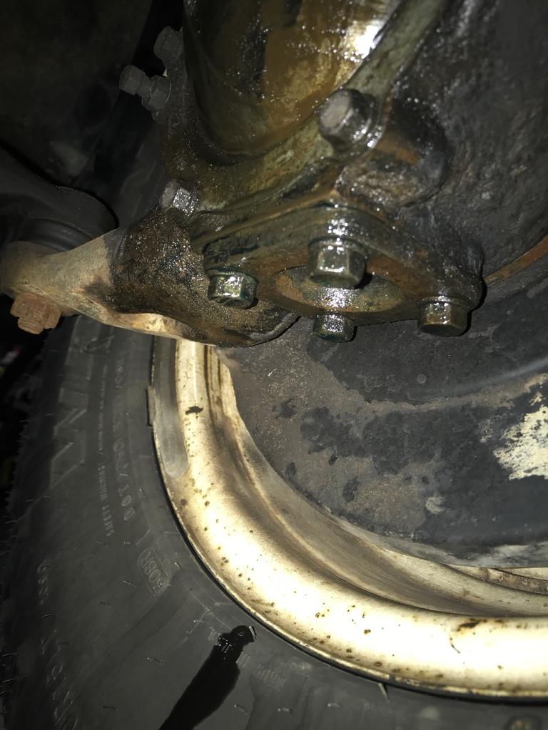

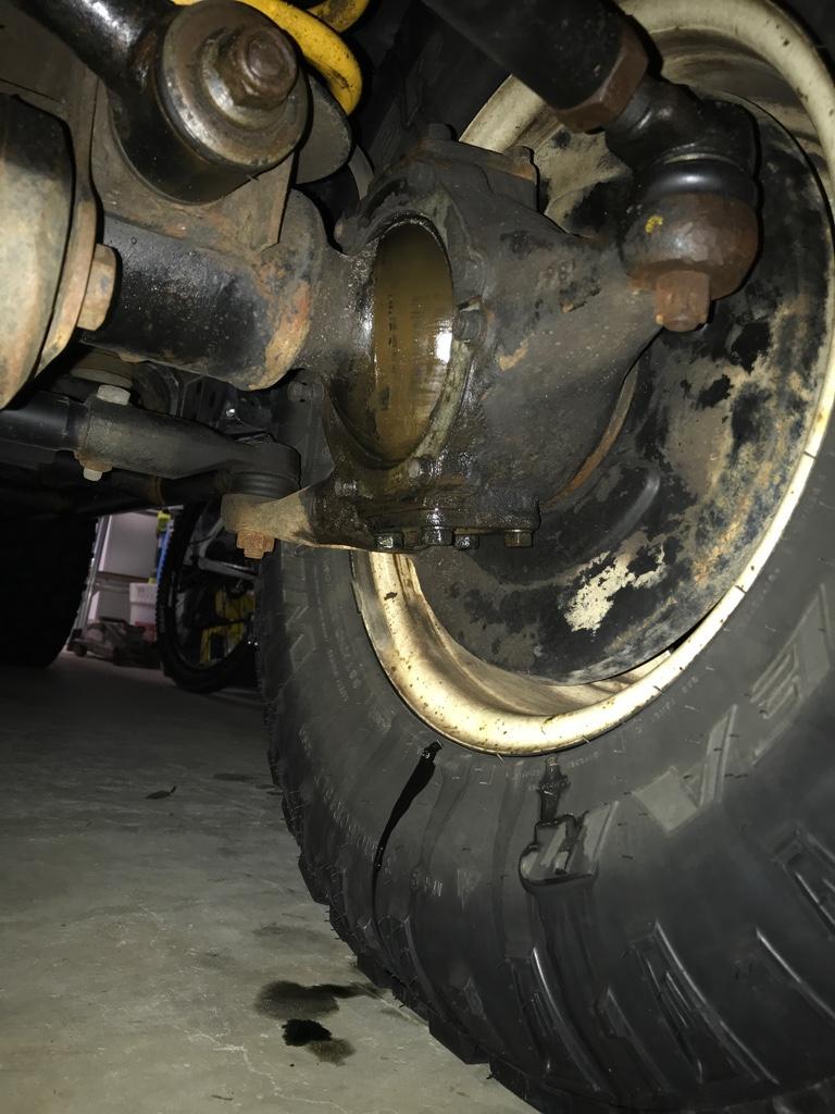

    Noticed some diff oil weeping from one of my swivel hubs...
    Just got back from a week long 4x4 trip on Fraser Island... don’t think it was leaking before.
    Had both swivel hubs rebuilt about 1.5yrs (<5k kms ago).
    Assume it’s a perished oil seal. Any thoughts?

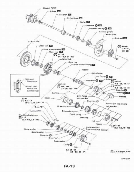

    Far from a mechanic me Nowlzy Mate, but from this little iphony screen looks like you are correct, simple axle oil seal gone.
    Not a huge fix, wheels/brake/stub axles off & out. Slide each axle/cv joint out and pop in a new OEM seal.
    Recently bought a very helpful cheap tool from SCA for this:
    https://www.supercheapauto.com.au/p/...er/417966.html
    FWIW: A nearby mountain work mechanic recently suggested to me that overfilling to plug height front (not constant 4wd) diffs can put excessive pressure on our axle seals.
    In saying that you mention Fraser Island which I’m assuming is still these days 80km legal high speed front 4wd diff spinning heat too?

    Will just be an axle seal mate.

    Thanks guys,
    You maybe right about the diff oil level.
    I don’t do a lot of 4wding and level is at full.
    I’ll change the seal and check for any wear on the driveshaft.
    Might then keep the diff oil level a bit lower and see if that helps at all with next seal.
