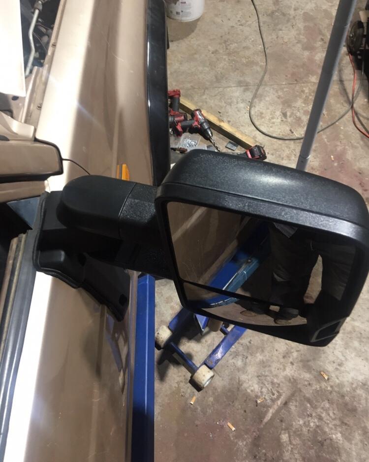

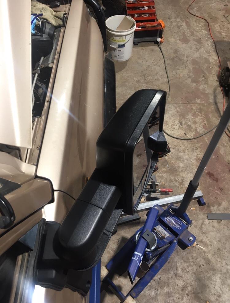

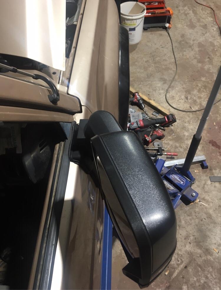

    [url].............
    You could make the 79 series mirrors work but if it were me I would just buy the purpose made and designed ocam versions. They weren't available when I did mine.
    Thanks again for the lead Chrisso Legend!
    Spoke to a lovely young helpful lady at Ocam late last week and today....free delivery to work as I was in no rush
    First impressions so far, they appear extremely well heavy cast, certainly a stronger contour mounting design from the old farm spec mirrors I was truly worried about peeling the door panel open if ever clipped.
    Bottom holes unfortunately didn’t line up, no big problem and no doubt the old farm doors issue and not Ocam’s.
    Again not Ocam’s design problem but I will deliberately look to voiding my warranty by delving deep inside their folding mechanism to hopefully achieve an easy extra 10-15 degrees off their OEM bump stops for gnarlier track needs/wants
    Standard driving position is an incredibly strong ‘lock/click’ can honestly say I’ve never passed a Road Train wild enough to flop these rippers back IMHO
