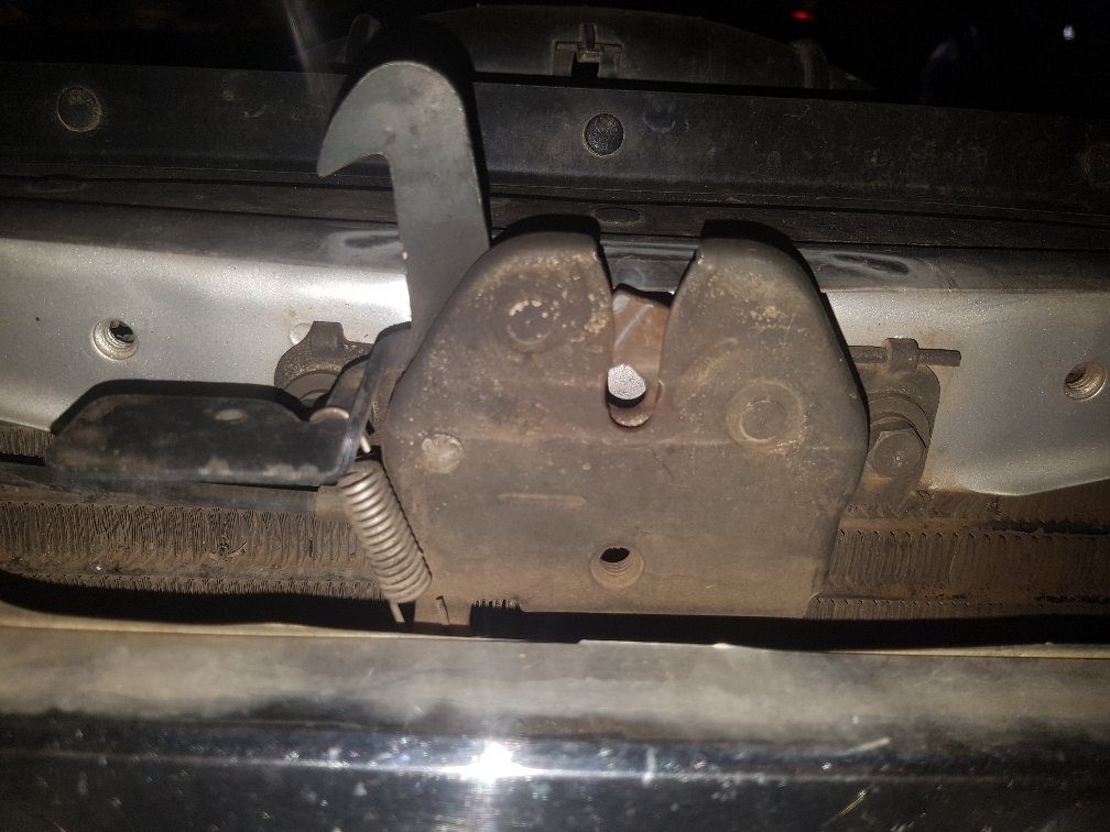

    Here's a pic of mine with bonnet already up. .
    That looks just what i have, but won't slide around to engage the bonnet latch.

    Hey there Pee Bee, hows it going.
    Just make sure that the safety catch is not causing the problem. It may be slightly miss aligned.

    OK, after another 2 hrs jinking around it appears the mounts of the bonnet catch have bent/twisted and the catch is bending downwards, so the solution appears to first bend the legs back and then slightly elongate the mount holes to lift the assy up and allow the catch to engage. I think there may be a very slight interference with the s/c case, so the scoop opening needs a poofteenth shaved off. Finished for the day, frustration level exceeded.

    So, that didn't work either, the ears of the catch mechanism are snagging on the cavity in the bonnet - looks like the entire cross strut in front of the radiator is twisted and cocking the catch over. So, I zipped down to the wreckers and bought another one. Bugger me,. still not closing. I have put 10mm of packers under the arms and the gap at the rear of the bonnet looks ok. I just need to resolve the catch - tomorrow, truck and i are not talking right now. What has changed since I closed it earlier this week and now - no idea.
