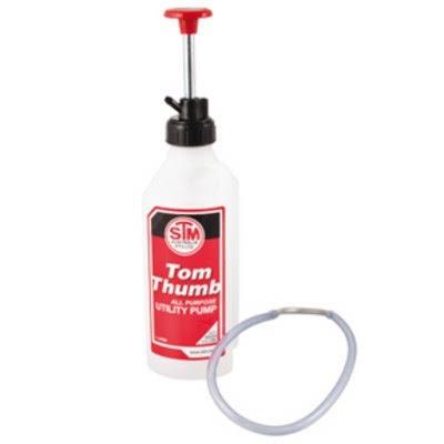

    Worth trying first maybe a nuffy Hills Home ‘reverse bleed’ of clutch & brakes if messy possible?
    Clutch slave wise, try positioning a 2L Peters Ice Cream tub below its firewall master cylinder (cap off) and ‘Tom Thumb’ type pump from the bottom back up top off the bleed nipple below
